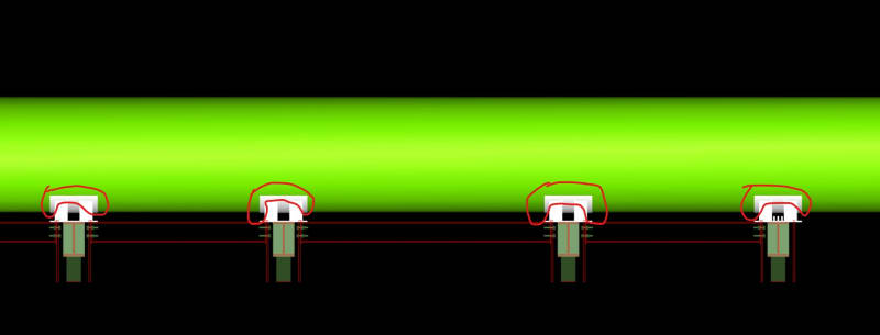

Talking about need of FEA, my concern is related not only on the possibility of pipe flattening, but stress rise and concentration on support points, in the plate around pipe saddles (red areas/indications below). Of course it is directly related with pipe support span, but we can simulate some scenarios and find the 'ideal solution' between rising thickness or reducing pipe support span, or evaluate the need for some kind of pipe reinforcement.
Did you mean to draw it a series of flat sections?
That is a very thin pipe and this supports don't look big enough

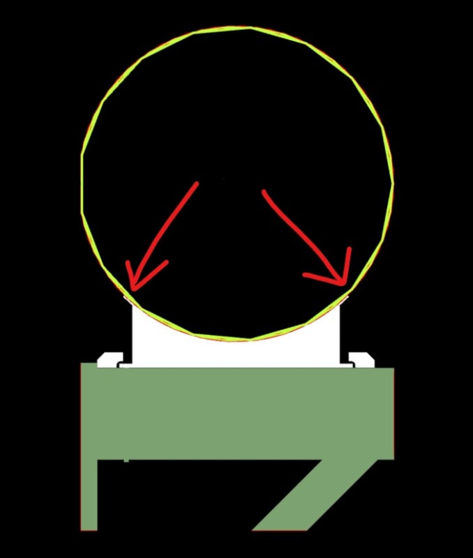

About pipe flattening, what I meant to say is the possibility of occurring pipe buckling/ovalization due to excessive loads on these saddles supports. This configuration (outside diameter = 76" and thickness = 5/8") is out of condition D/T<=100. Using FEA we could determine if this thickness is enough, this would be my personal choice. But I'm searching for alternative codes to try to escape from FEA.
