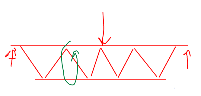

Thanks, KootK. My sketch isn't exact, of course. I show bracing on the compression flange - isn't that all you need? It wouldn't be hard to brace the entire height, but I don't see any advantage.
Usually? It's kind of a tricky question to answer that robustly.
Imagine if your beam were really the top chord supported steel joist below. Here, we can agree that the joist would roll over catastrophically, right? The bottom chord would kick out laterally?
Next, ask yourself, what about the your real beam prevents this same outcome? I would say that it's two things:
1) The beam bottom flange acting like a girt to restrain itself laterally at the point of load application. Calling this beam torsional resistance is just another perspective on the same thing.
2) The load being applied below the top flange such that a couple is formed that would tend to resist the bottom flange kicking out laterally. This you've probably got in spades too if I'm envisioning your situation correctly.
Both of these mechanisms are real, no doubt. But neither usually gets evaluated explicitly and neither is as "positive" as positive lateral bracing to the bottom flange would be. That's why , for something that feels as though it might be pretty high stakes, I wouldn't mind some positive lateral bracing to the bottom flange.

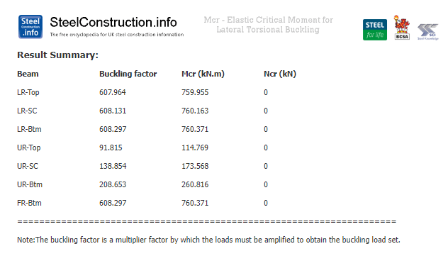

@KootK These are results from elastic LTB analysis.
305x165x40 universal beam spanning 5m.
Restraints: LR=top flange lat restraint at midspan. UR=unrestrained at midspan. FR=full restraint at midspan.
Point load misdpan: Top/shear centre/btm flange.
Top flange load isn't destabilising if applied at restraint location because no section twist. Opposite of that is no benefit of btm flange load because no twist.

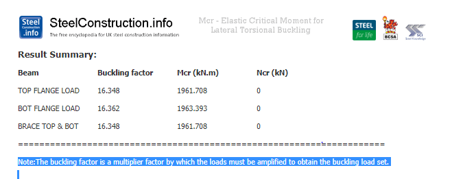

I did some monkeying around using the same tool and came up with these results:
1) Bottom flange loading appears to be irrelevant for this situation.
2) The low brace appears to be irrelevant for this situation.
I was using a slender 610 @ 10m span and top flange lateral braces at the quarter points and mid span.
So thank you for setting me straight on this.
