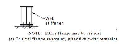

As noted in this thread here, I don't trust AS4100 treatment of stiffeners as restraint for deep beams. I will be having a look at this in the next month or so as I intend to provide a much more robust twist restraint on my portal beams. (This is for the same structure I mentioned earlier supporting 900T.)

Why don't you trust the twist detail, assuming it satisfies the 2.5% rule?
Well for starters the 2%/2.5% rule is a cheat itself. It is about stiffness not about strength. Secondly AS4100 doesn't explicitly require the 2.5% rule for stiffeners. Thirdly all this is the assuming the column is perfectly laterally restrained is also a big assumption. Lastly, rigour. I don't mess around with buckling. I've dealt with all sorts of funky structures prone to buckling that I know enough to know that I don't know enough! Cylinders under external pressure (or vacuum) are a fun buckling experience.
So no I don't trust the twist detail, so I'll investigate it.

You got me thinking.... And this would be an easier enough detail to test using FEA eigen value buckling approaches. So I crunched some numbers. 610UB 9200mm effective span. 200kN top centred load with no restraints except at the beam ends. These were the results
3.7073 with fixed ends 9200 LONG (HOGGING MOMENT)
3.2001 bearing with fixed ends 10000 LONG (400 bearing each end) 9200 effective span (HOGGING MOMENT)
1.7385 bearing with 3 stiffeners pairs 10000 LONG (400 bearing each end) 9200 effective span
1.3284 bearing with 1 stiffeners pair 10000 LONG (400 bearing each end) 9200 effective span
0.9528 bearing with no stiffeners 10000 LONG (400 bearing each end) 9200 effective span
0.7371 pinned @ center 9200 effective span
A single stiffener pair wasn't much more effective than none at all.
The bearing connection would have provided some out of plane rotational restraint. The fixed ends would have provided full out of plane rotational restraint.
Overall a quick comparison with AS4100 results all lie within expectations with the exception that stiffeners really don't magically improve the lateral bracing of the critical flange for a long 620UB.

The comparison wasn't about L restraints. It was a specific reply to address the influence of stiffeners in providing a suitable restraint to the critical flange. I believe this analysis shows that is not necessarily the case.
The only analysis's giving hogging moment are the ones were it is explicitly stated. (The first two)
The next two have a fixed bearing connection. In theory this should give some hogging moment but in practice fixing just the bottom flange struggles to give a full moment connection. Semi-rigid would be the best description.
The last two are clearly pinned. In behaviour. And the stiffener only gives a minor influence in restraining the top flange.

The lack of end rotational restraint makes a big difference. The stiffener doesn't provide that to the top flange. Whereas an end plate connection could provide more. (Depending on the lateral/torsional stiffness of the member it is attached to).
Yes you lose any rotational restraint with the stiffener. However the image above seems to show the stiffeners providing effective twist restraint?
Are you assuming rotational restraint in the other cases?
True. Which sort of invalidates my 'distrust' of stiffeners as twist restraint.
The first two have rotational and warping restraint and which largely aligns with your results:
"Rotation restraint increase these number by ~10% . Rotation restraint AND warping restraint increase them by ~100%"
