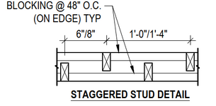

What I have done in the past is providing blocking but on the vertical, so that the air gap remains between the blocking and the stud of the other face of wall. Blocking gets fastened into the sheathing. So you're effectively bracing the first 1 1/2" of stud instead of just relying on sheathing. Here's an image:
Mine was a 2x8 stud cavity with 2x6 studs, but should work for you. My studs were also not laterally loaded for wind (these were only used at load bearing partitions on the interior of the building for sound attenuation, but I think this would be sufficient as long as you sized each stud to take full 24" of wind, instead of 12" since the outside face doesn't touch the inside stud.
This shouldn't affect their overall goal of thermal break, so they might not push back as hard as you'd initially thought.

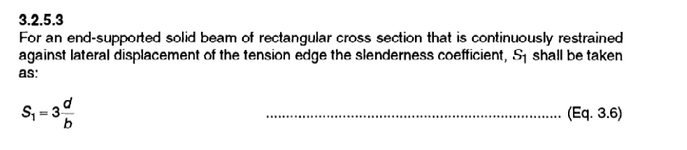

Our code allows tension face restraint to count (compression side would obviously be even better)
I've always interpreted 'continuously restrained' to allow sheathing with discrete fasteners at 150-300mm crs max in the context of residential framing

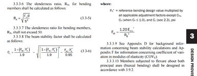

In the formula (that I am not familiar with), is higher S1 good or bad? S1 would increase for deeper studs if d=depth and b = thickness is held constant.
In the formula that XR250 shows (from Appendix A of NDS), le/d would get smaller with deeper studs if d = depth is substituted for le/b, then I assume the allowed stress changes in the Rb portion of allowed bending as shown below. Rb would go down, thus increasing FbE.
The Appendix A provision appears to be saying if your sheathing is not easy to distort, it will be more difficult to buckle the compression face of the stud. I am still trying to picture why a deeper stud is less likely to buckle than a shallow one under this appendix option and therefore allowed to have more bending stress.
Ron, higher S1 = bad (number = how slender it is, higher = more slender)
I suppose I left out the useful context of the normal equation - basically, reverting to 3*d/b is hugely favourable over how the same beam would calculate out if it didn't have tension edge restraint

I'm confused, Celt. Looks like CL is based on Rb which is based on le b/d.

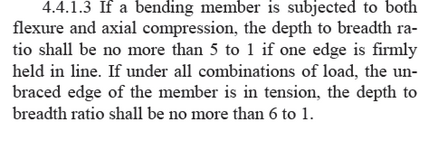

Interesting I've never personally used section 4.4.1 to take CL as 1.0 but looks like a wall stud would qualify as long as you meet 4.4.1.2 and 4.4.1.3.
Did not even see 4.4.1.2 but looks like a 2x6 works if the ends are nailed

Le for use in the Rb formula should come from Table 3.3.3, for uniform wind pressure usually ends up as the 1.63Lu +3d formula, where Lu is the stud height.
