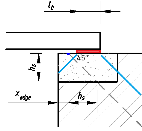

Hi all,
I have a question regarding structural design (I am doing it to BS 5628) of concrete padstones - primarily in this case where they are close to or right at the end of the wall.
In this example case, I have a beam 100mm wide bearing on the end of a wall:
I require the load to be spread more than it will be without a padstone and so I am putting one in. Until now I have been using Tedds but am now questioning it. The formula they use basically just multiplies the stress at the base of the beam by 2/3 - I am not sure why this is but it does not seem right/a good way of doing this.
I have made a preliminary calc that basically just uses triangular stress distribution to obtain the stress at the bottom of the padstone after taking a 45 degree line but I would like to know how others do it so that I can have a better idea of the best way to go about this.
Cheers,
Aiden.
The bearing pressure might spread out at 45 degrees normal to the beam span, but the direction in your sketch I would use maybe 1.5*Lb as see how that works out.
The applied load needs to be equal and opposite of the reaction in the wall.
Quick solution - 100x100x10mm bearing plate and centre the beam on the centre of the padstone. This will put load down the centre of the padstone. I often have to do this when loads get too high to just be sat as shown.
If you are worried about tie forces, make it a 200x100x10 and put an anchor into the padstone.
I call those bearing bars when I put a piece of steel to promote rectangular stress distribution. It's often narrower than 100mm, but also sits on top of a larger steel bearing plate. It essentially instantly doubles the bearing capacity of the plate where the steel beam sits on a masonry wall.
