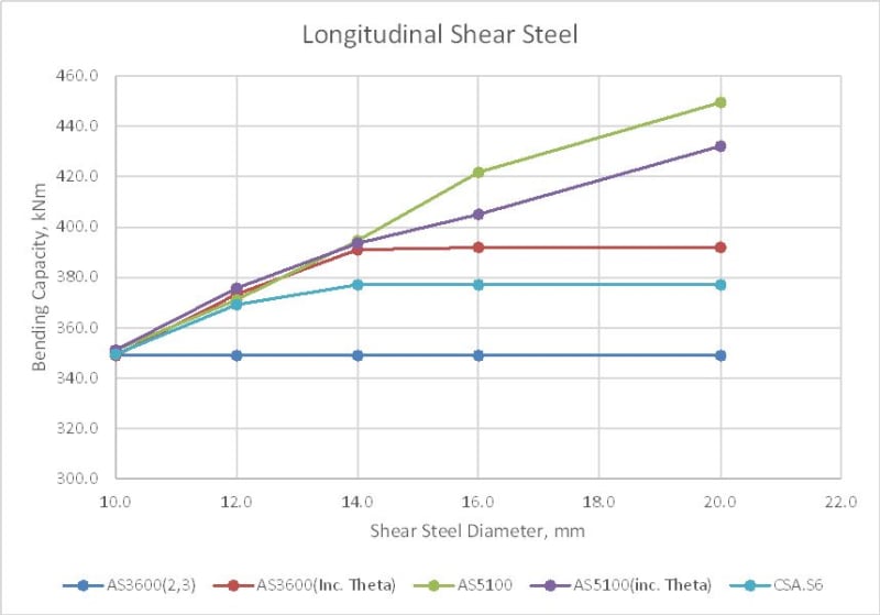

To compare the different code requirements, and the different approaches to applying them, I have looked at the bending capacity of a rectangular beam, including shear effects, when the shear reinforcement is increased from 10 mm up to 20 mm. The beam had a bending capacity of 446 kNm with zero shear, and a shear capacity of 275 kN with 10 mm shear reinforcement at 200 mm spacing. I checked the bending capacity including shear effects with a V* of 275 kN, for the following cases:
1) AS3600, rev 2 or 3, with the shear inclination angle (Theta) according to the code refined method.
2) As above but with Theta increased to reduce the shear capacity to 275 kN, up to a maximum of 50 degrees (equivalent to the maximum mid-height strain of 0.003).
3) & 4) As 1) and 2), but to AS5100 rev 1.
5) As 3) but with Phi.Vus limited to V*, as required by the Canadian Code.
In summary:
Case 1) Increasing the shear reinforcement has no effect on the bending capacity.
Case 2) Bending capacity close to the AS5100 results, until the limit on Theta of 50 degrees is reached, then constant. Note that this is fully compliant with the current AS 3600.
Case 3) Increasing the shear reinforcement area continues to increase the bending capacity, to an unrealistic degree.
Case 4) Some reduction in bending capacity, compared with 3), for 16 and 20 mm steel, but still much higher than 2).
Case 5) Similar results to 2) to 4) for 10 and 12 mm, but the limit on Phi.Vus is more conservative than the AS 3600 limit, at least in this case.
On that basis I'd suggest that the current AS3600 method, with adjusted Theta, has reasonable limits, without being too conservative.

Could you please describe the steps in your calculation for Case 3 which resulted in an increase in bending capacity from an increase in the area of shear reinforcement ?
do u think the variability across codes is a bit concerning?
C
I have just posted a more detailed description of the analysis (together with a link to the spreadsheet used for the analysis at:
But in brief:
Case 3 is just using the AS5100.5 code formula for the longitudinal force due to shear, and finding the adjusted bending capacity, allowing for the force. Increasing the shear reinforcement reduces the longitudinal force, so increases the bending capacity.
For Case 2 increasing the compression block angle (Thetav) reduces the concrete shear force, and also reduces the cot(Thetav) factor on the longitudinal force, so it increases the adjusted bending capacity, up to the limit of Thetav = 50 degrees, equivalent to a mid-depth strain of 0.003.

Quoted IDS "Increasing the shear reinforcement reduces the longitudinal force, so increases the bending capacity"
Doug,
For given V*,M*, Ast(provided),Asv(provided) and s, where M* < Φ Mu and V*<Φ(Vus+Vcs), increasing the amount of shear reinforcment A_sv(provided) increases the shear capacity ΦVu [= Φ(Vus+Vcs)] but not the moment capacity ΦMu. Is there an assumption I am not aware of?
kww2008 - I am looking at the bending capacity under combined bending and shear, including the longitudinal force due to shear. Increasing the area of shear reinforcement allows the angle Theta to be increased (up to 50 degrees)[pre][/pre], which reduces the longitudinal force due to shear, so increases the force available for bending.
See the link in my earlier post for more detail.
