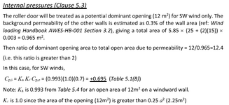

Overall the change to the internal pressure with local pressure changes hasn't greatly changed the outcomes, the wind ward local pressure factore is 1.5 and the area is 0.25a2, for a 12x12x3.5 that is an a of 3.5, which gives an area 2.6m2, and if you opening is greater than this area in the example building than that KL is 1. They you compare this to background permeability you will be down the table, and a larger opening like a roller door will govern, that is unaffected by KL.
Internal suction, well that is a different story, it is higher generally, however I don't find this changes the worst design Case of CW + IP.

Overall I don't find the outcomes significantly different, just a few extra calculations to show the larger opening is the governing rather than the small 0.25a2 and has a slight lower internal pressure due to kV.....
Overall I would encourage people to do the calcs and see if it really has a impact. A group of North Qld engineers spent a heap of time doing different setups of existing buildings to see if they could be certified as as1170.2-2021 and came to be conclusion that for most building the 0.7 was still a conservative/acceptable assumption for internal pressure coefficient. This was in region C.

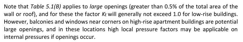

As an example, I was just considering ridge vents that are not uncommon in Region D. I assume this would be local region RA4, leading to Kl = 2.
Or a PA door or small window that's failed. Even if the building is designed for full internal pressure, the local pressure factor would be 1.5. I would assume most buildings would need to be designed for a window failure and a local factor or 1.5?

I do a fair few building in high wind zones with ridge vents, I am yet to have an issue with local pressure factors once you take averaging into account or m2 rules etc.
