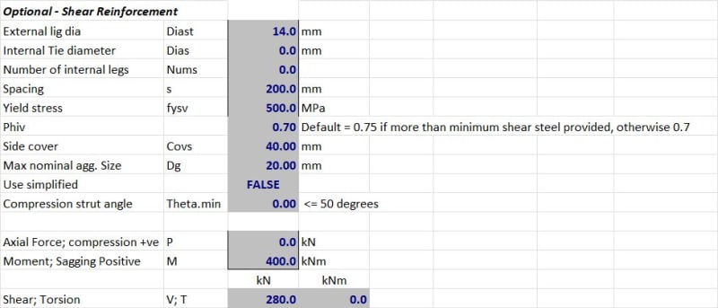

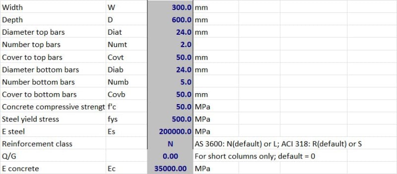

More details of the section used for the graph I posted on 17th Sep:
Cross section and longitudinal steel:
Shear steel and applied loads:
The only inputs that were changed were:
The shear steel diameter.
For AS 3600 with adjustment of Theta the "Compression Strut Angle" was adjusted to reduce the shear capacity to 280 kN, with a maximum of 50 degrees.
For AS 3600 the moment capacity results were multiplied by 0.8/0.85 so that they had the same Phi value for bending as AS 5100.5

Thank you Doug for the information. What is the Vu from using the input above ? When I used this value in my spreadsheet, using equations in AS 5100.5, my theta_v is less than 50 degrees. The value phi_v shown is 0.7. Should not this value be 0.75 since more than Asv.min provided ?
Vu values are:
Dia, mm Phi.Vu, kN
10.0 274.6
12.0 350.8
14.0 440.8
16.000 544.6
20.0 793.9
Yes, ThetaV is 37.56 degrees. That is why it can be adjusted when using the AS 3600 provisions.
I have just used the lowest possible Phi values across all the codes, to keep everything the same, other than the equation for longitudinal force.

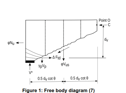

If you look at the ASSHTO force diagram, you have to maintain horizontal force equilibrium,vertical force equilibrium and rotational equilibrium (except they forgot to add the moment etc).
In their model,( assuming it is complete even though we disagree), The only vertical forces are Vu, Vs and Vc (which for some reason you think you can ignore).
The whole derivation if done properly requires
Vu = Vs + Vc .
You cannot then ignore part of this in deciding on the Vs limit. You cannot create vertical force. You cannot ignore one force. If you put in more vertical steel, the stress in the steel reduces. The force stays basically the same to maintain vertical equilibrium. The vertical reinforcement cannot attract more force than exists.
Just because 2 other codes have decided to ignore statics does not mean we should. Otherwise other designers around the world could be saying " but AS5100 says Vs is unlimited" so it must be.

Suggest you get hold of a recent copy of AASHTO bridge Specification to view the diagram and the assumptions made, and to see the equation is derived. In AASHTO 2010 5th Edition, this diagram has a label "Forces Assumed in Resistance Model Caused by Moment and Shear". An assumption is made that Vc (which is acting along the assumed diagonal crack) has a negligible moment (owing to having a small lever arm) about point 0, a point near the top of the diagonal crack.
The failure mode of interest is rotation of the block, so Vu = Vs + Vs (the requirement for section shear) has no relevancy to this "determination of the requirement for tension force in the longitudinal reinforcement". Section shear is a mode which has to be designed for separately.
The calculation of longitudinal force in the longitudinal reinforcement is based on the assumption that the full resistance from the vertical steel Vs (yielded) is mobilised and the acting force is Vu. If the vertical steel is not at yield ( if excess vertical steel is provided), that does not invalidate the use of the model because failure in this mode requires both the horizontal and vertical steels to have reached yield. That is why one has the flexibility to adjust the amount of vertical steel provided and the amount of horizontal steel required.
The figure of the block shown in the Concrete2023 conference (reference given above) by Vimonsatit, Wong and Mendis (2023) is reproduced below. Note the typo error - label Vp should read Pv.
