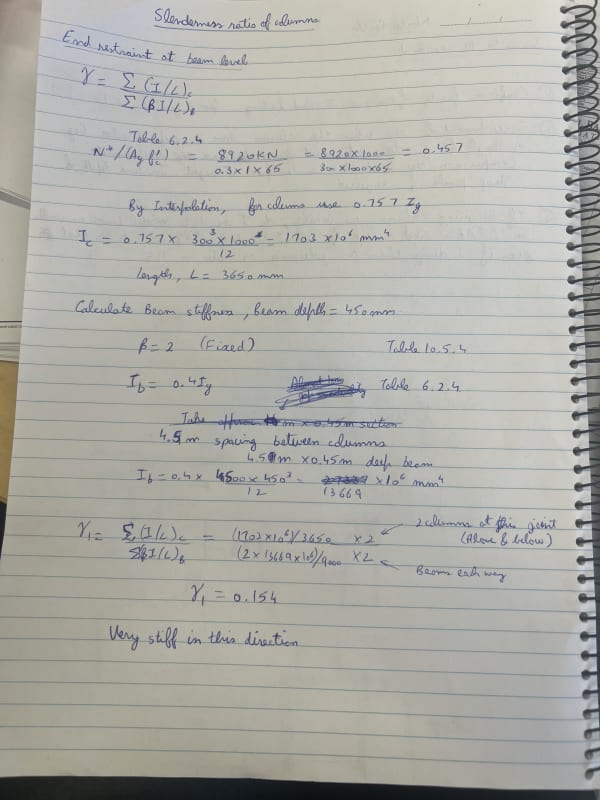

The issue is for some of these columns, I have got the above column at 90 degrees, which means I cannot get all the bars through from the bars under. I am thinking about putting a 750mm deep drop panel so that I can develop my 12N32 bars in compression, 700mm. What would be the sandwiched section is this case? Surely, the whole drop panel will be engaged and I can design the drop panel as a strut and tie to transmit the forces from the column above to below.
Also, I am using k=0.7 for these columns and will be designing the pad footings for bending moment from the column.

k = 0.7 feels very unconservative for me however, I'd avoid if possible. Hard to justify the rotational stiffness of the pad footing, has a heavy reliance on geotechnical behaviour for stiffness. Between two slabs you can do the manual calculations to get your k values based on relative column to floor stiffnesses

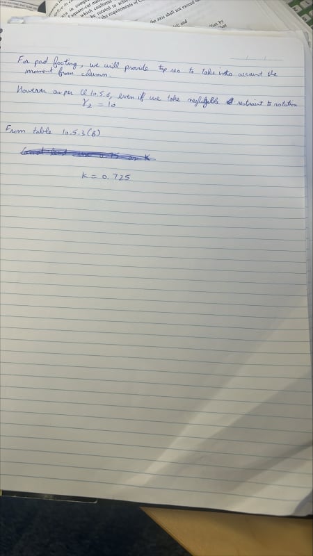

aah yep that makes sense. I have done some calcs and tried to make it work without taking any rotation into the pad. I was able to get gamma as 0.15 for slab and if I consider gamma for pad footing as 10 which means no rotation, I am still getting k=0.725 if my calcs are correct. My slab above is way longer but I have only considered 4.5m being conservative.
You have made a mistake with you effective length gamma factors. Look at figure 10.5.3(A). 0.7 is fixed fixed. You can't achieve that with a pad footing, and a slab on one end can't provide equivalent stiffness of two fixed ends. At best you can achieve 0.85, probably higher with a rotating column over.
This isn't an axial transmission issue, it sounds like a slender column design issue.

Thank you for your reply. What you are saying makes sense that we can’t have two sides fixity 0.7 just from the slab. However, I looked at commentary and it says that that figure is just an approximation where fixed ends are allowed a bit of rotation. That is why I used the stiffness method to get the fixity of the column at the slab end and my gamma value is 0.15 as per my calcs above unless I did something wrong.

My thoughts are that you're grasping at straws to justify k=0.7, when it clearly can't be achieved. I suspect you have a calculation error in your gamma factors. The figure is approximate - so is the stiffness calculation. You have no idea what the true stiffness of the slab/column/footing is, so it never makes sense to use such an aggressive k factor, unless it's a thin column wedged between two deep beams - something that clearly provides near full fixity to each end.

I see a few issues in your k-value calculation.
1. you apply a stiffness reduction to the column. However, these are intended for lateral resisting elements (so they should be applied when analyzing lateral loads, not gravity loads), and it's unconservative for the k-value calculation to reduce the column stiffness. You should leave the column stiffness as 1, as under gravity loads the columns will be fully uncracked.
Likewise, for your slab, the modification factor you used is intended for lateral resisting elements. However, 0.4 seems to be a fairly conservative value, so it may be acceptable in this case. I usually use between 0.25 and 0.35 for spanning members assumed to be cracked (unless they are PT).
2. You are ignoring the Young's modulus of the concrete in the column and in the slab. It will be higher in the column and lower in the slab. Ignoring this assumes the Young's modulus is the same, which in your case is unconservative (because the column has a higher concrete grade).
3. Using beta = 2 seems unconservative. I usually use 1 unless you really have a fixed connection or something extremely stiff, like a large shear wall parallel to the beam or slab. I'd suggest using 1.
In your case, adopting the above, I calculate a gamma1 = 0.76.
Associated with the gamma2 = 10 from the footing, your k-value is just under 0.85, which agrees with the fixed-pinned configuration, as mentioned by BentEng. Never assume less than 10 for an isolated pad footing even if you design for the moment. The gamma depends only on stiffness not on strength and the stiffness of an isolated gravity pad footing will likely be very small compared ot the column bending stiffness (unless maybe you pad is extremely large and on stiff rock..)
