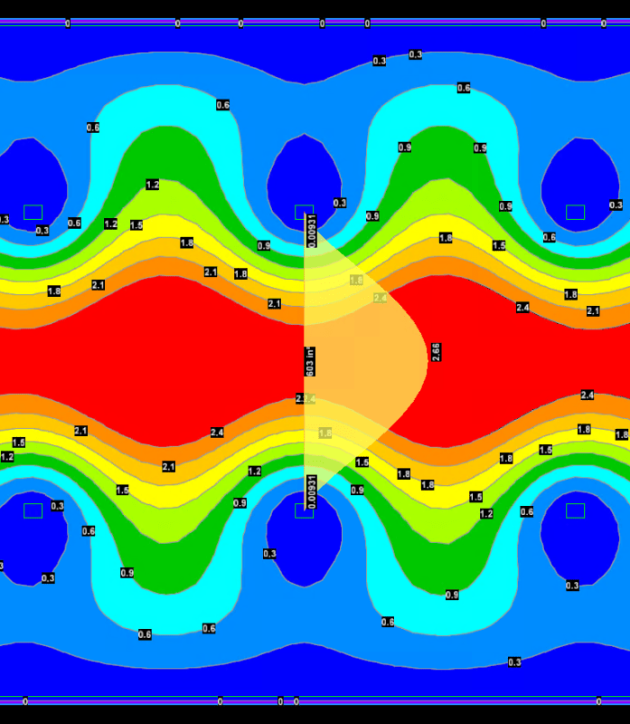

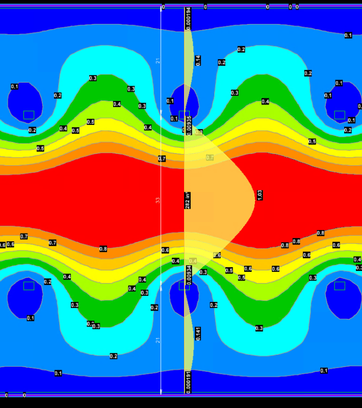

I ran a simplified model based on your description:
10" thick Flat plate
21,33,21
Exterior Continuous Walls
Interior Columns (fixed at slab, pinned at foundation)
top and bottom mat of reinf. of #6 @ 12"
At 7-day load history with just self weight I get 1.03" of deflection:
I ran several more loads steps with 2 steps being 1 day of a +125 top surface temperature + Self weight and 1 day of a -125 top surface temperature + Self weight to cover a single cycle of + and - thermal exposure.
At 6 months load history I land on 2.66" of deflection:
I'm making a thing: (It's no Kootware and it will probably break but it's alive!)
