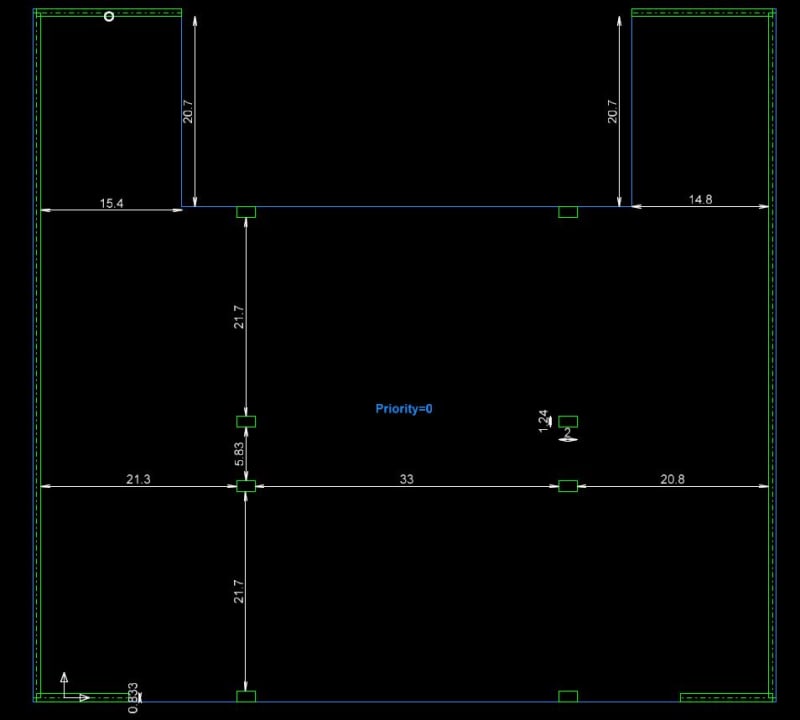

Post a sketch of the floor plan so we can understand what you’re talking about.
Below is a simplified floor plan of the slab
With that arrangement of perimeter concrete walls your shrinkage restraint should definitely be set to severe.

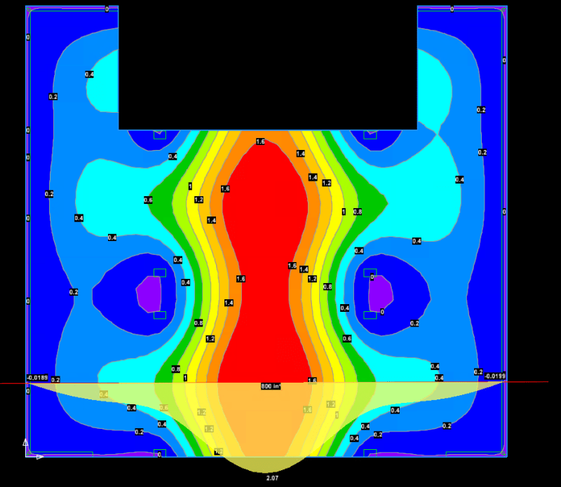

I land on 2" after load history considering temperature effects:
From the manual load history does not consider load patterning so the 20 psf construction live load would be considered over the whole slab, if they stacked material in the central bay only that would increase the deflection. Concepts method iteratively cracks the design cross sections if your number of design cross section divisions is too large not enough areas of increase curvature will be picked up it then averages these stiffness over each finite element, the analysis is also still linear elastic so any p-delta effects aren't captured. The mesh size itself will also impact the results a larger mesh will be inherently stiffer than a finer mesh.

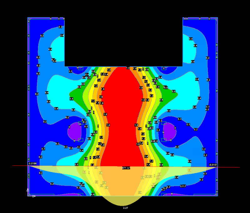

I get 0.8" with just self-weight after a single 10 day load history (3ft mesh, 2.5 ft max section division, per the manual though results less than 90 days contain a lot of variability not captured by the analysis so the validity of the results is questionable):
Long term (250 days +/-, 10 days initial, 60-days of construction activity, 180-days of inactivity) with a 1 ft mesh and 1 ft max spacing for the latitude strip divisions, 2.27" total deflection:
again this wouldn't capture any patterning of the construction load. the 3' mesh size was a good estimate, this tighter mesh is an even better estimate but we still haven't captured everything that impacts the deflection.

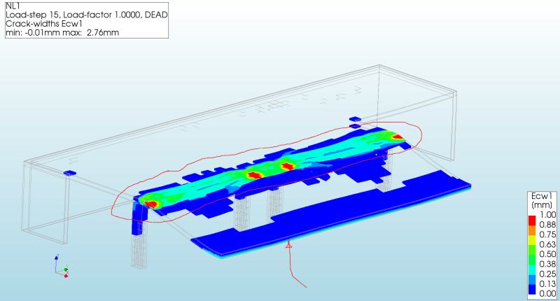

Did you have the construction team pressure wash the slab or anything to look for cracks? I would expect cracks in this slab design shortly after the forms were removed and by now I do not see how they would not be visible. The slab image posted is basically symmetrical about the vertical line, so I modeled 1/2 the slab with some arbitrary supports. The image below show the estimated cracking with only the dead loads.
