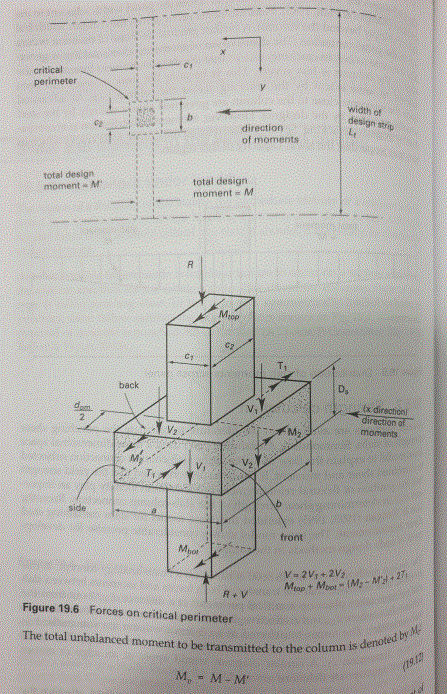

But AS3600 seems to have a different method and it's not easy to follow just based on the code and commentary as it rolls up the formula into sort of a reduction factor for moment compared to the zero moment case. Not stresses like ACI. So I dug my old textbook out of storage over the long weekend and it looks like the stress distribution is different to ACI. The front face seems to have the average shear stress while the side faces vary linearly due to shear+torsion so the shear stress at the corners is different depending on which face you're looking at.

Here are 2 pages from the textbook. The first shows the force distribution around the cone and the second shows how the code equation 19.26/28 relates to stresses. The stress equation isn't in the code or commentary. You can see in figure 19.6 equations that all the moment is direct moment on the front/back faces or torsion on the side faces unlike ACI.
Safe to follow the book and check the two directions separately?
