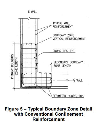

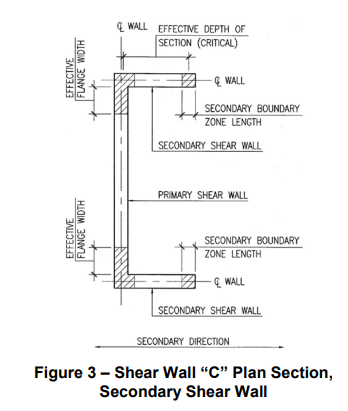

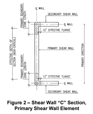

I have found few instances where the definition of "end zones" and "boundary regions" is applied to compound walls corners and wall instersections.
For example

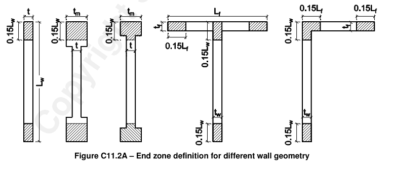

ALso, his is the definition of "end zones" in NZS 3101 (although I admit these zones do not really apply to boundary regions, rather to the minimum reinforcement zones)
In any case, to me this makes sense and I am more inclined to assume corners and intersecitons as discontinuity regions and end zones, not just free ends and door locations, especially in absence of a clear definition of these in the code.
Yes I know that thread, I even commented on it :-) however I dont see any references to the claim that a discontinuous edge is only at free ends and doors, just some other people saying what is their understanding.
Generally speaking, I believe geometric discontinuities are not limited to a geometry "ends" but more broadly to abrupt changes in geometry that lead to stress concentrations. A corner of a core wall and sometimes also simple wall intersections definitely experience stress concentrations, therefore I am more comfortable considering those for boundary element detailing, until proven otherwise.
I 'd be stoked if I didnt need to worry about boundary elements detailing at core corners, however until I see some sort of clear definition or reference, personally Id prefer to keep it conservative.
