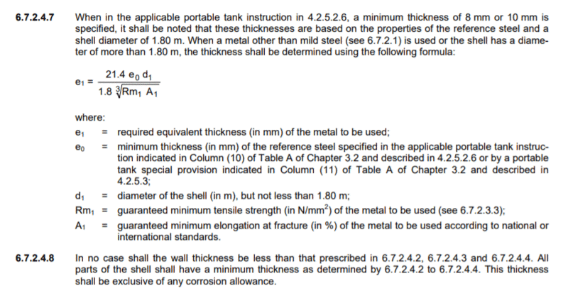

I was able to track down the reference... it does appear op is using the correct units mentioned in the code paragraph 6.7.2.4.7
fwiw my quick calculation was: e1=2.3mm if I plugged in 0.4 for A1; and e1=0.03mm if I plugged in 40 for A1. The latter is arguably the strict/literal way to interpret a request for numerical input "in percent", by analogy to how the other inputs are requested "in mm" for example... but I don't think that's what they intended.
More importantly, while I was there, I did happen to notice the very next paragraph after op referenced is 6.7.2.4.8, which states "in no case should the wall thickness be less than that prescribed in 6.7.2.4.2, 6.7.2.4.3 and 6.7.2.4.4". So once you do your 6.7.2.4.7 calc, then the next step is to check if those other sections might dictate a minimum thickness higher than the result of 6.7.2.4.7

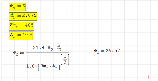

Try putting in A1 = 40 rather than A1=40%
As I mentioned above that part is ambiguous.
(2B)+(2B)' ?

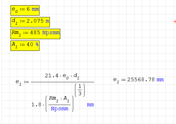

Something like... I have no idea of what was just calculated...
Not to me... never seen it before.

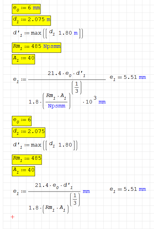

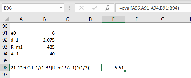

In Excel (using my Eval UDF, but really just as easy with standard Excel formula):
The message being (in my opinion), when you have a formula with inconsistent units, just use the units stated and keep it simple.
