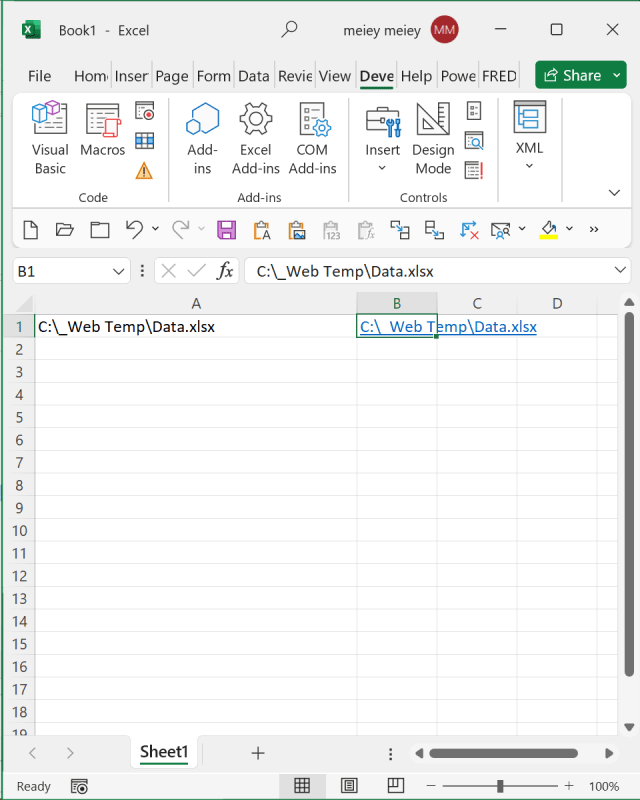

posted a screen shot ... shows a cell contents as the link address (and cell displays the link value). I copied the link address into the file ('cause I don't trust these things !).

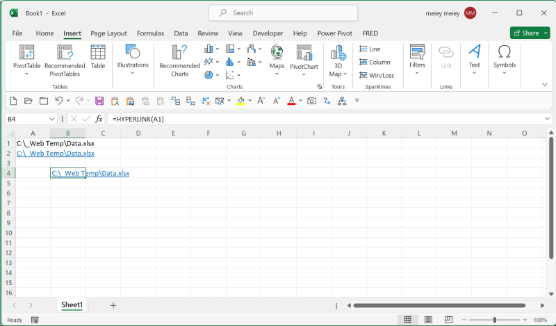

The simplest thing to do, I think, is to use an adjacent column and insert "=hyperlink(I34)" etc. which will create a hyperlink similar to what you might have gotten had you used the "Insert Link" toolbar command originally.
Alternately, you could create a macro to copy the contents of each cell with a link and do a proper Insert Link

Code:
Sub Macro2()
' Macro2 Macro
    target = Range("A1").Value
    Range("B1").Select
    ActiveSheet.Hyperlinks.Add Anchor:=Selection, Address:= _
        target, TextToDisplay:=target
End Sub

That's because it's just string data; it's not a link unless "Insert Link" was activated. The XML versions of the spreadsheet shows that the cell content includes an extra field that identifies as a hyperlink, which is distinct from the displayed contents, just like the Eng-Tips TGML hyperlinks allowing for a display being different from the actual link. So, in Excel, you have to have explicitly used "Insert Link" to get a clickable link.
<Cell ss:StyleID="s62" ss:HRef=" ss:Type="String">vs.
<Cell><Data ss:Type="String">
The former shows that the "Cell" has a hyperlink HRef, as well as the displayed "Data" string while the latter shows only. Note that ET's TGML took over the link strings above, so that's not Excel doing that.
