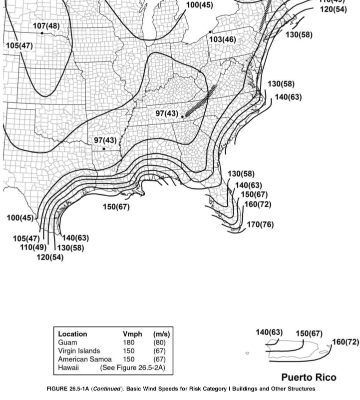

[tt]I am looking for an electronic definition of the maps in ASCE 7-10 for wind and snow.
The ideal solution would be a Google map that has the contours drawn as custom lines.
If that existed, I could get a definition of the contours as a list of latitude and longitude coordinates, put them in a database and find the
wind speed at any location by some programming.
As it stands, I am going to have to create these maps, which is a messy, time-consuming task.

I wouldn’t spend a lot of time programming exactly for latitude and longitude, since those contour lines are probably not accurate/definitive to much more than +/- 5mm anyway (ya think?). Sometimes a little engineering experience and judgement are required in pretending to be a real engineer, not just a bigger, better, more expensive program. Furthermore, most local AHJ, States, Counties, etc. might have made minor adjustments to meet their own experience or local stds. and customary practice. If you work in the region, you probably know the local stds. and requirements, if not ask the local AHJ.
I agree with dhengr, those maps are most likely not as accurate as your methodology would make them appear. To know the wind speed as accurate as you suggest, they would have to have thousands of accurate wind speed recorders that I am pretty sure they do not have. At best you are going to save 5 mph over the current system.
Also, I have used 2 different maps that did have latitude and longitude. There was a slight variance on the the values for a house I could zoom into on both maps and see. I could put my cursor over the roof on both. The difference in the values sometimes ran for several houses away.

The seismic data you can pull via a web API request to USGS, see here for an example: LINK
The wind data isn't freely available the ATC website will give you access to their API, again handled via a web request but requires a license key to get a response from the API: LINK
Neither tool will capture local code requirements
For the wind tool I've seen the approach where the contour areas were traced with closed polygons and the image normalized to lat,long reference then using a point in polygon algorithm determine which contour polygon the specified location was in and report back the wind value.
