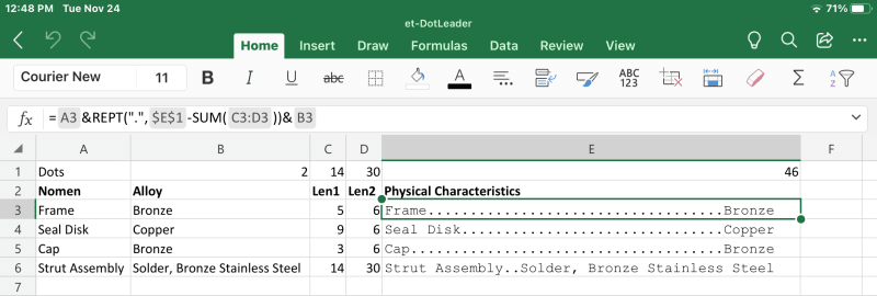

Is there any tricks to get dots in-between text, in excel sheet?
Text should be left and right aligned as shown below.
Thanks in advance :)

What you posted is a feature of a document editor like MS Word. In Word you can create such as described here.
But Excel is not a document editor but rather a spreadsheet editor. You can get part of your request using the uploaded solution which includes using a fixed pitch font like Courier New.
BTW,
Variable B1: User supplied, min number of dots
Calculated in C1&D1: max length of data
Calculated in E1: total max length of Physical Characteristics

If the left word and lots of dots are left justified in that cell and the right word is in the next cell and left justified, it will look sort of what you want except the right words will be left justified. It does not matter how many dots over "enough" or how many cells there are between them.
If you can't use that, you'll need Skip's solution
Certainly, with the two-column option I noted you can get something that looks about right with some adjustment.
Agent666 - I imagine what is described below is the same as you used, but your instructions were not very clear!
In cell C2: =A2&REPT(".", $C$1), text is left justified.
In cell D2: =REPT(".",$C$1)&B2, text is right justified.
Copy down as far as required.
Adjust column widths to display all the text.
Adjust the number in C1 to provide enough dots (or just hard code a big number).

My requirement is exactly matching with the solution provided by SkipVought.
