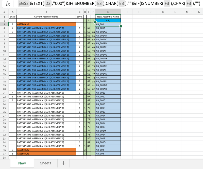

Need a rename macro for excel
I've found the easiest way to create macros for many things is to record them - start recording, perform the steps you want the macro to do, then stop recording. Then, it's just a matter of adding/editing to make it repeat the steps.
How about a spreadsheet solution?
Added 3 columns in lt green
My results in lt blue
D3: =IF(LEFT(B3,8)="ASSEMBLY",RIGHT(B3,LEN(B3)-8),F2)
E3: =IF(ISBLANK(C3),"",IF(SUM(C2:C3)=1,65,IF(C3=E$2,E2+IF(OR(E2=72,E2=78),2,1),E2)))
F3: =IF(C3<>F$2,"",IF(AND(C3=F$2,C2=1),65,F2+IF(OR(F2=72,F2=78),2,1)))
G3: =$G$2&TEXT(D3,"000")&IF(ISNUMBER(E3),CHAR(E3),"")&IF(ISNUMBER(F3),CHAR(F3),"")
Workbook below.

This Excel workbook solution looks interesting but considering i would have approx. 1000 parts to generate names for this would be a difficult task for a person who has less knowledge on Excel formulas.
The answer is a macro that pastes the formulas into the sheet when the user doesn't know how to use "FILL DOWN" or "COPY" and "PASTE" to duplicated the formulas.
You could also pre-populate the sheet with 2000 lines of formulas and protect the whole thing except the input column.
Unless your specifications are incorrect or incomplete, this could easily be accomplished if your table were a Structured Table (Insert > Tables > Table). I will send and example. Right now I'm not at my work station.

I did a few modifications.
1) Inserted a Structured Table
2) Moved the New Assembly Name prefix above the table as well as 2 other pieces of data
So here's the drill. The data to Copy/Paste is on the Data sheet or you can use your own 2 columns of data.
1) Copy the 3 columns of data for new part numbers
2) Paste that data into the FIRST data row of the table
Voilà y'all!
You need NO KNOWLEDGE OF EXCEL FORMULAS to use the workbook I uploaded above. PASTE in 10,000 names if you like. The results are nearly instantaneous!

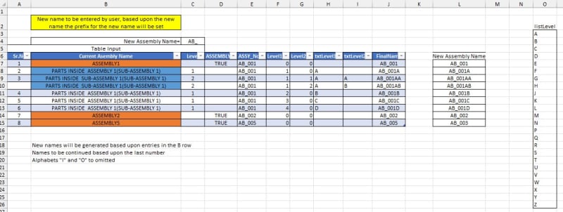

Here's my solution using normal functions. No macro required.
My approach is to first divide it into bite size pieces, so I deal with each level separately and combine those into the final result. It's easier to debug this way. I have used two columns to find the text for Level1. You can go back afterwards and combine these two columns if you want.
I have used a table. The advantage is that formulas will be auto filled down a column. Rows can be easily added even in the middle of the table.
I have put the level codes into a named range so that I and O are not included. This can easily be expanded for additional levels by say adding in lower case letters.
