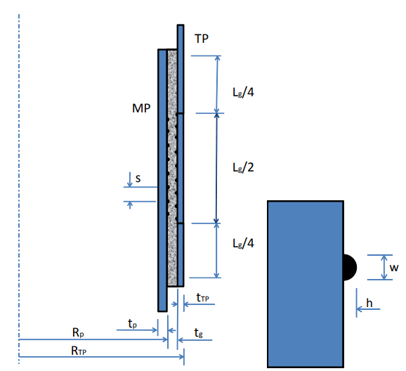

I am trying to make a finite element model of a grouted connection with shear keys in monopile:
However, even though I can make a model I am not sure if its correct as I have no experimental data to compare with. I found a paper and design codes online and I am not sure which of these I should compare with (or if there is even any point in comparing the data), and would like to hear a second opinion.

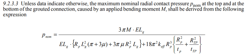

Could I apply a bending moment to my model and check if the maximum nominal radial contact pressure at the top and at the
bottom of the grouted connection is the same as the output from the model? - would this make sense to confirm the accuracy of my model?

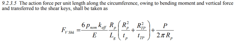

Can I use this for comparison - find spring "action force" model and see if its the same as the equation?

Your picture implies weld bead. The beads can be weld bead, round bar with fillet welds , flat bar with fillet welds.
P.S. The allowable bearing stress shall be limited 20 psi for service loading and grout strength shall be limited fcu ≤ 16,000 psi

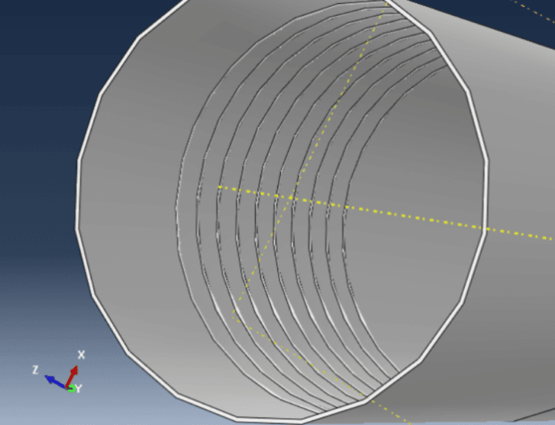

The shear keys look something like this, they go along the entire circumference:
So the axial load will simply be carried by the shear keys, I can measure the load the shear keys are carrying and see if it makes sense (make sure it takes all the self weight and potential axial load).

Those equations in your first post, what publication do they come from?

Dear Retrogade: its DNV-OS-J101 - Design of Offshore Wind Turbine Structures - Section 9.2.3.
link below:

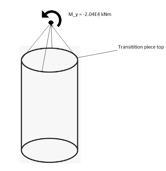

I use Abaqus CAE, and moment applied can be anything, but lets say -2.08E4 in the y-direction. The loads in this model (moment, concentrated force etc)is applied to the transition piece top, it is applied to a top point which distributes the moment averagely across the top (structural distribution).

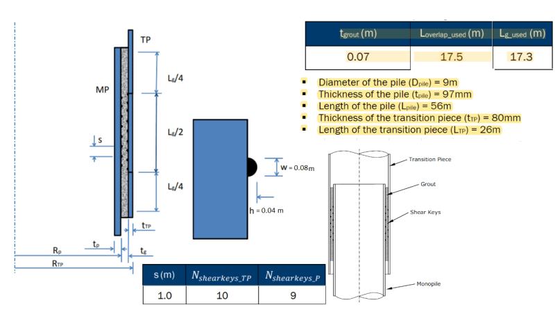

Dimensions are shown below.
Dear drennon236 ;
Lets check your dimensions ;
Sleeve geometry = Ds /ts = 9000/80 =112.5 ?? should be less than 80,
Pile geometry = Dp/ tp = 9000/ 97= 93 ?? should be less than 40,
Grout annulus geometry = Dg/tg =9000/70=128 ?? should be less than 45
Shear key shape factor = w /h =80/40=2 O.K.
You provided a nominal moment My= 20400 kN -m , and assume a axial load W = 50000 kN.
The max. shell compression force at transition piece Nc= W/(Pi* D )+ 4*Md /(Pi*D**2) =50000/pi*9.3 +4*20400/pi*9.3**2 =1711+300 = say 2000 kN .
the nominal allowable axial load transfer stress for the grout fba= 0.138 + 0.5 fcu*h/s=´0.138+0.5*40*40/850 =0.95 MPa
No of shear key required= 2000000/1000*40= 50 no's You are expected to provide 50 shear key for transition piece and 50 shear keys for monopile. The shear key spacing could be 300 mm .. in this case, the overlapping length will be 15000 mm.
This is a preliminary calc. based on nominal loads and i did not check for calculation mistakes..
I will suggest you to look API RECOMMENDED PRACTICE 2A-WSD (RP 2A-WSD) Commentary Section C.7.4.4d.
You are free to perform finite element analysis with abaqus but your design should be based on calculations which are verified with tests.
