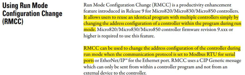

I am using a Rockwell Micro 820 configured as a Modbus-RTU slave device.
Is there a way for the user to change the slave address without giving him access to the application code?
Check out the RMCC (Run Mode Configuration Change) function described on pages 23-26 (pdf) of Micro820 Programmable Controllers User Manual
It sounds like it might do what you're asking:
That works. And it's fairly straightforward once the MSG_CIPGENERIC function is properly configured.
I am now able to change the Modbus RTU unit addresses from the HMI or via jumpers on PLC inputs.
I was also able to use the same method to set the Ethernet IP address.
