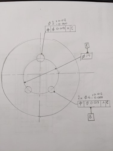

Looking into you guys advice , would the attached drawing be a legitimate way to reference the part.
My thinking the part would locate an orientate from datum A and B .
Although the rest of the features on the part would be positioned to datum C.

The logic in your new drawing appears to be a bit circular. The bolt circle is defined as datum C, yet the holes that make up the circle are positioned to C...
I would call your planar datum A, and I would call the 2x bolt pattern datum B as you have done. Orientation tolerance on B to A (no secondary datum) and possibly a second position segment (no datum) for hole-to-hole position. Then you can position the third smaller hole to A|B.
Yes i know , My question , if I use the bolt circle as Datum B , i do not have any orientation control ?
I need to be able to basically square the part up using the two Ø4 dowel holes. Then use the Bolt circle diameter as the center point of which all other features will be positioned to.

Rwelch9, is there a reason the dowel holes are now of different sizes? Weren't the 3 of them the same size in your initial post? If that is because of what was discussed regarding the rotational degree of freedom constraint (that 2 are enough for), I don't think it's a good enough reason to change the size of one of the holes. Datum feature C seems to be called out incorrectly but that can only be corrected after the decision whether this is a pattern of 3 holes or a pattern of 2 holes and another hole of a different size.

Yes always been 2x Ø4 and 1x Ø3.

It's hard to answer for sure without seeing how the holes are currently dimensioned, and the drawing in the first post of the thread doesn't show that. But if it resembles how you showed it in your last sketch then despite being located on the same pitch circle, the 3 holes are technically not a pattern by the rules of ASME Y14.5, because the number of places does not precede a common specification for the 3 holes, and also because there is probably no simultaneous requirement for them (in your sketch there is but as Jacob noted the choice of datums is problematic) So there is a pattern of two 4 mm holes and another single 3 mm hole.
This is how I would establish the DRF according to the function you described:
* The flat end face is datum feature A (a flatness control should probably be added for it).
* The two 4 mm holes are datum feature B controlled by position to A (controlling orientation and mutual location). See the figure I attached in my previous post for how to designate this pattern as a datum feature.
* The third hole is datum feature C and is controlled by position to |A|B|.
Other features on the part are controlled with reference to |A|B-C|, which means that datum features B and C lock 1 rotation and 2 translation degrees of freedom together and have equal importance.

The positional control of the two 4mm dowel holes with reference to datum A ensures both orientation relative to datum A and their location relative to each other.
Controlling the 3mm hole for position with reference to |A|B| with datum feature B being the two 4mm holes ensures orientation relative to A and location relative to those two holes.
Right now on the drawing it states the dowel holes have to in position to Datum A, this allows the inspector to orientate that part any way he chooses as there is no clear instructions on the drawing .
If you have 2X 4mm holes positioned to A and 1X 3mm holes positioned to A you would have a simultaneous requirement. They would be considered part of a single pattern, no need to orient one to the other - they are fixed in relative orientation.

Simultaneous requirements would fulfill this requirement, and would even be in my mind a better control of relative position than 2X 4mm to |A|, designated datum feature B and then 1X 3mm to |A|B|.
Agree with chez311 that if currently the two 4mm holes and the one 3mm hole are controlled by position to A, there is a simultaneous requirement. I missed that part in the post where I said they are not a pattern. With the simultaneous requirement, they are.
I suppose that if you change datum feature A to be the functional end face instead of the non-functional (for interface) cylinder, and you designate the pattern of all 3 holes as a secondary datum feature B, this |A|B| DRF can be another functional solution for constraining 6 degrees of freedom for controls applied on other features on the part.
chez311, do you have a suggestion on how to designate the 2X 4mm plus 1X 3mm pattern as one datum feature in terms of datum feature symbol placement? I think that using "two datum features - single datum" concept for features that are part of the same pattern may not be quite right.
I think it would be acceptable to denote the 2X 4mm as B and 1X 3mm as C and reference |A|B-C| as you previously suggested. That is, if its not acceptable to hold other features in simultaneous requirements to A as well, which is also an option.

if i went for 2x4mm as B and 1x 3mm as C .
Datum B-C would that be the center point of the PCD which would be made up of all 3 holes ?
