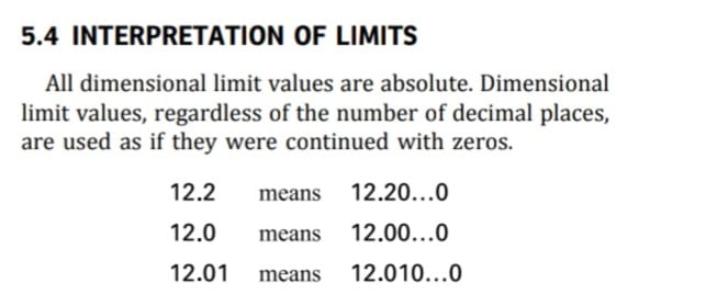

So if we consider this Y14.5 rule:
Making the efforts to measure by a system that can distinguish between 1.39624 (Fail) & 1.39625 (Pass) for a dimension given as 1.40625 +/-0.01 makes no more sense than making the efforts to measure by a system that can distinguish between 1.29999 (Fail ) and 1.30000 (Pass) for a dimension given as 1.31+/-.01.
Burunduk,
Does this section 5.4 not support the idea that limit decimals are driven by the resolution of the nominal [edit: in this example], as the limits are defined to infinity?
What am I missing?
E.g
1.31 +/- 0.01
1.312 +/- 0.010
1.3124 +/- 0.0100
1.31241 +/- 0.01000
etc...
Mech1595,
You are not wrong,
But it also means that 1.31+/-.01 is the same as 1.3100+/-.0100 , as a requirement. So why use a much more accurate measurement system for the latter (or much less accurate system for the former)?
Let's say I have a post length that reports as a nominal of 1.31 at 2 decimals. But if I increase the decimals, the nominal becomes as follows:
1.31
1.310
1.3104
1.31042
The inclusion of more decimals results in a stricter definition of the dimension. Even if the dimension is 1.310....0, the concept is the same; 0 is still a number, and I have to validate the components to the precision dictated on the drawing.
1.31
1.310
1.3100
1.31000
1.31
1.310
1.3104
1.31042
The difference between those values would only matter if they were all borderline conditions relative to the allowable dimension range; for example if 1.31 is the upper limit. That upper limit could be expressed as 1.31, 1.310, 1.3100, or 1.31000 without any difference.
In your example once the fourth decimal is determinable the part is rejected for measuring 1.3104 (fail). But since the limits are absolute, technically the part must also be rejected if the actual value is 1.310001. Even if measuring to that accuracy was somehow practical, I don't think anyone would insist on such measurement when the requirement is 1.29+/-0.02 (which, according to Y14.5, means the same as 1.2900000000+/-0.0200000000).
Then, what should dictate the accuracy of the measurement system? I say it's the width of the tolerance band, not the number of decimal places on the drawing.
That is also why gagemakers' tolerances are 5%-10% of the related feature tolerance according to the applicable standards. Regardless of the number of decimals on the drawing.
