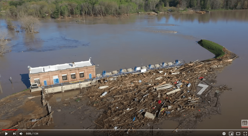

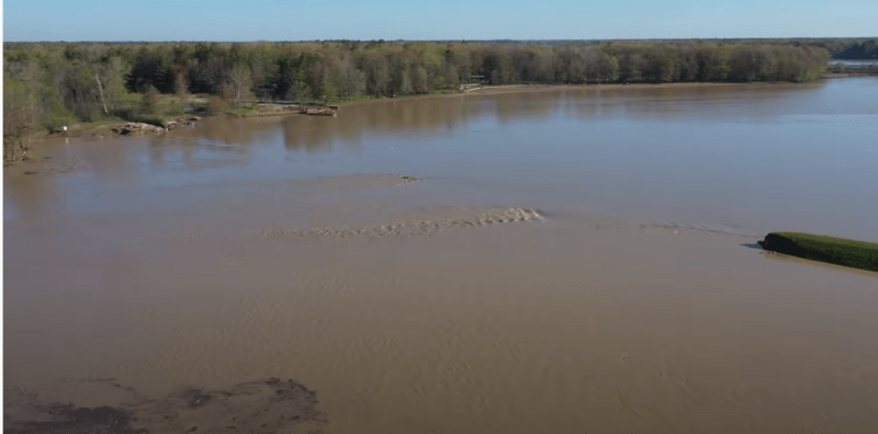

They can't see what is gone from Sanford dam until the water level drops, but this feature makes no sense. "However, Sanford Dam's "fuse plug" — a spillway feature designed to wash away in high flood conditions to keep the dam from collapsing — has been washed out."
From this drone video I rather suspect the Sanford dam is no more. Part remains, but the main section to the North west looks like it has been completely destroyed.
There may be some little hump remaining, but it will be several metres lower than it once was

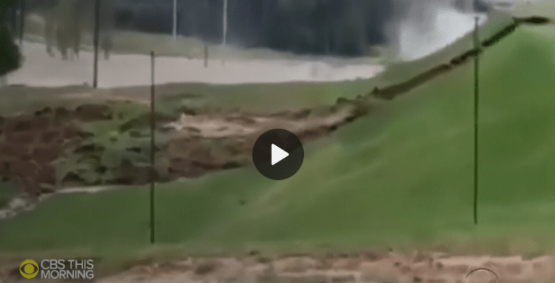

I'm still wondering what the initiating failure mode is for the Edenvill Dam. The video posted earlier shows the downstream face relatively intact, with some upstream depressions. There was water running over the crest indicated some form of overtopping, but did it overtop because there was a natural low spot along the crest, or did that potion of the crest settle because there was an internal erosion feature.
90% of my projects are Dam Safety projects on Earth and Rockfill dams, and I am waiting to see what the results of the investigation are, and if it will change our dam safety programs. However, I have a feeling this was avoidable based on current practices, but I will wait on a full investigation.

I suspect the fuse plug was that concrete structure but it only works if it is not completely destroyed by the water.
It's not clear if the mass of timber and debris is cause or effect in terms of blocking the main sluice gates, but any dam which is already high from rain to contain an upstream dam failure is asking rather a lot.
The initial edenville dam failure looks like a slope failure to me - see the video earlier posted by human909

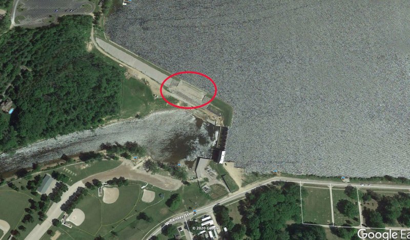

Here's an image from Google Earth showing the Sanford Dam taken in June 2018. I assume that the circled area is this so-called 'plug':
Compare this with the pictures posted by LittleInch. BTW, my wife has an Aunt who lives less than 3/4 mile Southwest of the dam and a 1/4 mile from the river. We tried reaching her yesterday but got no answer on either her cell or landline. If we don't reach her today, we'll try calling her son.

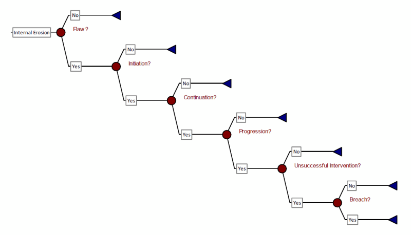

That was what caused the breach, the loss of downstream slope. However what caused the slope failure is what will be the initiating failure mode. If the video was a little longer before the slope failure, there could be a little more info. I am starting to think it was an internal erosion failure mode. This failure event tree shows how this would happen. A void was formed within the embankment from erosion, which then lead to a collapse crest when the void collapsed. This also gave a seepage path along the base of that slope failure; you can see the water flowing out just at the bottom of the mass of soil. The slope then failed, leading to breach.
Interestingly, both dams were rehabilitated with a toe drain system to help prevent internal erosion. However, it appears from historic aerial imagery on Google Earth that the portion of Edenville dam that failed did not have this toe drain system installed.
This is all purely speculation and my personal opinion, and I am waiting for more facts and investigations to come out.
Concrete cannot effectively erode, so it was not the fuseplug. The concrete spillway appears to have a soil cover based on aerial imagery. This soil would act as the fuseplug. On-the-ground photos will help establish that. I'm sure some of this is available through FERC.
