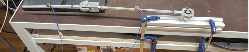

I am trying to perform a modal analysis for a 2 link structure that will have different orientations.
When I create 2 lines with 3 keypoints as you mentioned, then I need to add a joint element which will cause an additional dof. Because otherwise, they move separately.
I don't know what causes this, but the output of NSEL says multiple nodes are selected. For instance, when I enter 300 for sizing, it selects 17 nodes.
Basically, what I was looking for is creating a connectivity with those nodes.
I haven't used RBE3 before, I will look for it.
Thank you!
Regards.
Sorry, I don't really follow you here, can you draw a sketch of what you are modelling. Also if it is true links or struts, with only axial capacity, Link180 should be your element of choice, not a beam element with bending capacity.
/PB
This is my model. The joint on the left hand, has a connector,and that is what I am trying to simply model with Mass21 element.
I hope it is more clear now.
Regards
This looks like a planar linkage, maybe better to try textbook solutions for the kinematics or multi body dynamics? What's your load case here?
It is an impact test for eigen frequencies, so on APDL model, there is no load.
I am able to perform the simulation, just this C shape connector's weight is missing. That's why I am trying to find a way to add it as a nodal mass.
Thank you for you suggestion.
Regards
