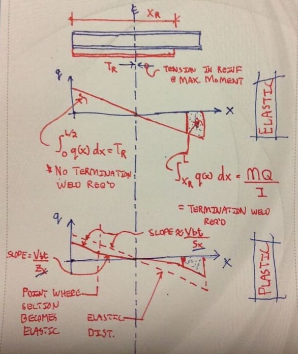

Some thoughts on your problem:
1) For the same set of internal actions (moments and shears), the shear demands on the welds will actually be less under the plastic model than they would be under an elastic, VQ/It. That's right, less and not more. I know, it's counteractive for most folks and certainly was for me when I started out. This is physically reasonable because, for the same moment, a plastic distribution will shift some of the axial stress out of the flange into the web such that it never sees the flange to web welds. For folks in the know, this is why you commonly see VQ/It use for plastic moment situations. It's expedient, conservative and, like Celt83 said, much of the beam remains elastic anyhow.
2) In a strict sense, both your intermittent welds and your end welds are doing the same thing: ensuring local horizontal shear demands are met close to where they naturally arise. That, so that composite action can be developed and the assumed, reinforced moment capacity can be reached. There's no "belt and suspenders" stuff going on unless designers deliberately add that which I'll tough on below.
3) In a strict sense, the end welds are not required if the reinforcing makes it all of the way out to the ends of the beam. It is only required if the reinforcement stops short of the ends of the beam which is often the case for practical reasons. That said, most everybody includes some form of end welding just to feel good about how things "get started" from a stress flow perspective.
4) In a strict sense, the purpose of the end welds is to rapidly introduce axial stress into the reinforcing so that, as quickly as possible, the reinforcing can be assumed to be sharing demand in an MQ/I manner similar to what you described in your last post. Quantified, that value is MQ/I and represents the intermittent, VQ/It welding that would have been present over the portion of the reinforcing not extended to the end of the beam if, in fact, that reinforcement had been extended to the end of the beam. See the sketch below.
5)#4 excepted, it is common for designers to fully develop the axial capacity of the reinforcement with the end welds. This does seem to be a conservative, belt and suspenders thing. The usual business about small $$$ begetting improved sleep. I don't ascribe to this myself and sometimes feel that it might be a vestigial hangover from the case of bar joist reinforcement where the practice is more applicable. I'll default to 6" end welds of the same size as the intermittent welds and only increase that if required by calculation. For a lot of reinforcement sections it doesn't make much difference but, as you pointed out with the WT situation, sometime it does.

Sounds nuts to me. You're referring to this article: Link? Can you post the relevant bits here so that we can review them?
iStruct said:
This kind of goes with what I was saying that the VQ/I is a bit of a safety factor for the intermediate welds if you use Fy*Ag at the ends.
Vehement disagreement from me on this. The end welds on their own cannot ensure meaningful composite behavior. This situation is different from the composite shear stud scenario in one massively important way: shear studs can be thought to be ductile with respect to horizontal shear and welds cannot. As a result, welds need to provide the required shear flow capability very close to where demand arises without relying on significant force distribution as we do with composite shear studs. This is why AISC has that provision instructing you to provide capacity in accordance with your shear diagram.

VQ/It will be either safe or conservative absolutely everywhere along the length of your plastically designed beam. Every. Where. Without exception.
iStruct said:
Personally, I would want at least some portion of my member to have bigger welds to account for the plastic force transfer.
There is no rational basis for this as the plastic model demand will be less than the elastic model demand everywhere and always.

- How do they calculate Tr?
- In the last paragraph, where they mention the minimum requirements, I would suggest that either:
a) VQ/It perhaps was calculated but the results have not been shown or;
b) the author is applying judgment in assuming that the 2" @ 12" welds would be sufficient for VQ/It.
There is another feature of that particular example that may be important / telling. With a paltry 4.8' of reinforcement in the center of a 40' beam, you'll be on the flat portion of the moment diagram in most cases and very little horizontal shear would need to be transferred over the length of the reinforcing plate. The author may well advocate a more conventional approach, including VQ/It checks if it were, say, 30' of reinforcing over a 40' beam. In light of the proportions used in the example, that simplified approach does makes sense to me. That said, I would not advocate it's use in general.
