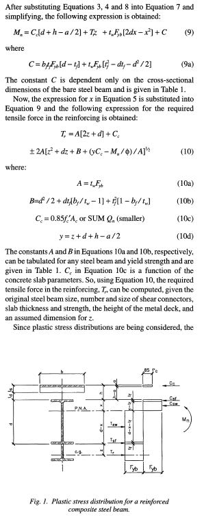

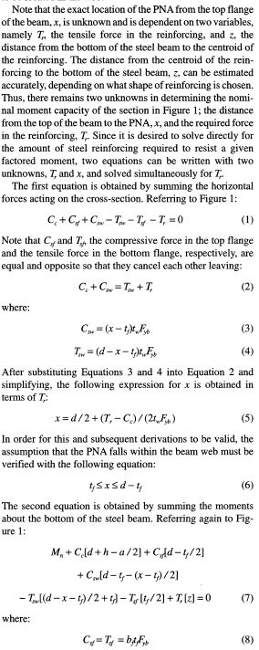

In the article "Tr" is defined as the required force in the reinforcing and is calculated as follows:

@dauwerda They do use Tr in multiple places like when they do the plastic analysis and then again in Step 5 for sizing the weld at the ends.

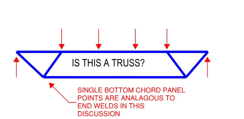

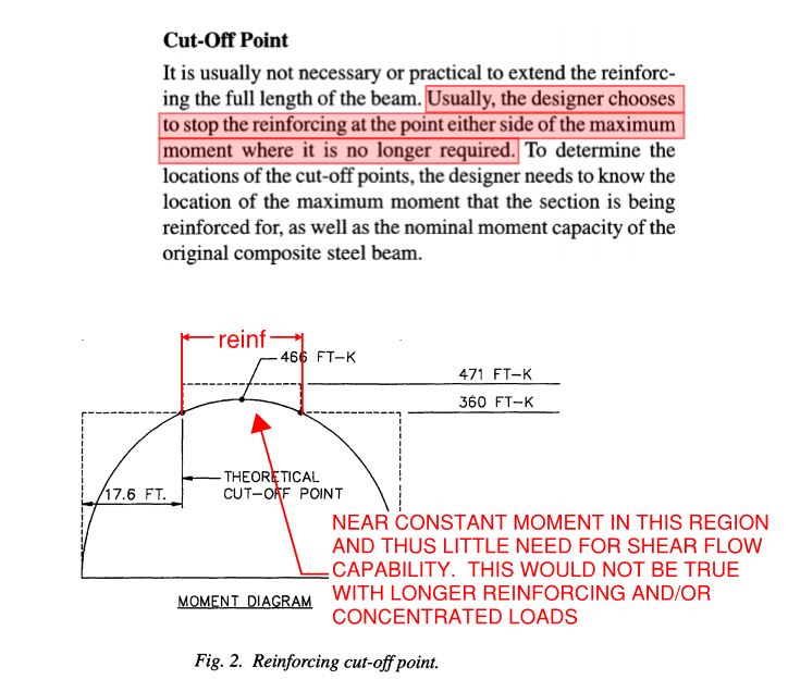

AND providing for shear flow between the end welds. Doing otherwise is akin to calling the thing below a truss.

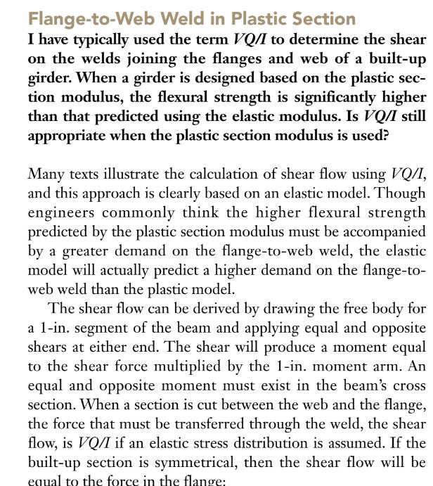

1) How much stock do we really want to put in one set of PDF slides with an unknown author? It's worth remembering that, often, these things are put together by other engineers just like us. And, therefore, our opinions are just as valid as theirs. This really is a pretty arcane topic and it would surprise me not at all if the author of the slides was not fully aware of the nuances.
2) By "not applicable", the author of the slides may well have meant "not strictly accurate", which is of course true. However, a thing need not to be accurate if it is universally conservative, not excessively conservative, and expedient as the VQ/It method would be in this situation.

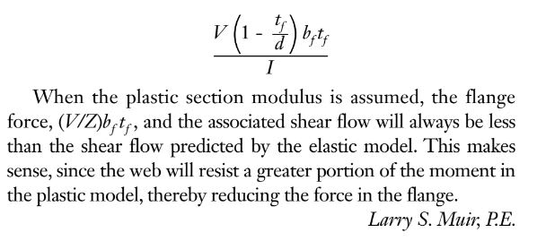

3) This topic was broached by Larry Muir in the July 2014 edition of Steel Interchange. I've included the relevant sections below.

Me too but, having procured and read the entirety of the article now, that seems to the case. In both the body text and the example, the author is clearly thinking about partial reinforcement as shown below. In my opinion, it was an oversight on the part of the author not to have mentioned the need for distributed, shear flow welding in many situations. It happens. As with with the slides, the author is just another engineer like us (principal at some firm), not a PhD / world authority on the composite mechanics of things.

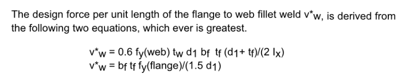

In New Zealand we have the following two generally accepted equations provided in technical documentation from one of our welded beam suppliers/manufacturers for calculating the weld demand.
The first criteria is the typical shear flow (VQ/I) requirement written out in terms of section parameters.
The second was initially unfamiliar to me, so I asked, the answer I got back was that it was intended for regions where there is yielding or section plasticity in hinges under seismic loading. Basically its saying take the flange force (b_f x t_f x f_y of the flange )and equate it to a constant longitudinal shear over a length of 1.5 times the clear web depth (1.5 x d_1). This 1.5 originates from the typical minimum plastic hinge lengths we have in our steel code. It inherent that there would be some development of overstrength in the intended condition where this check is applicable, however this isn't explicitly accounted for. I believe the 1.5 factor on the length over which the load is distributed and the strength reduction factors on the welds effectively cover this. Our maximum overstrength for seismic design is a factor of 1.35. Our typical strength reduction factor on welding is 0.8. This level of welding also imparts a degree of robustness under several cycles of an earthquake where a plastic hinge region might be subject to several reversals at a high ductility demand.
There is an error in the elastic shear flow equation provided in the July 2014 Steel Interchange response. The equation should have a 'd/2' term in the numerator. The omission has been confirmed by AISC. The other terms in the equation are correct. The shear flow assuming a plastic bending stress distribution, q=(V/Z)bftf, is correct.
Nice find, Hokie93.
Alternatively, AISC/Larry Muir may have meant for the denominator I to be S [ i.e. I = S/(d/2)] and get: (V/S)(1-tf/d)bftf to be in comparative form to his plastic flange force of (V/Z)bftf, which clearly shows that V/Z will be smaller than V/S (and the [1-tf/d] term).
