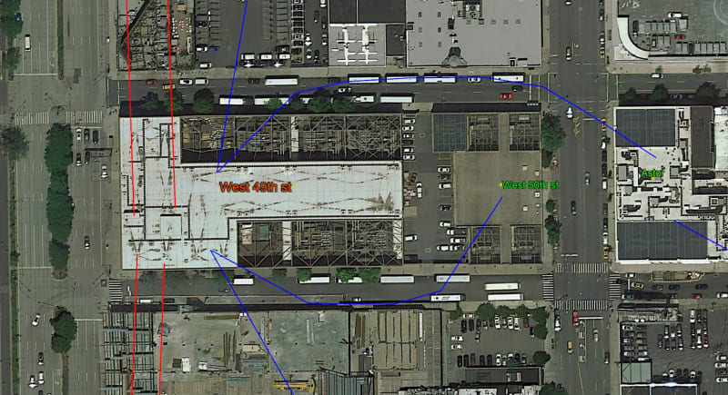

For the discussion, page 15 on the details of West 49th.
The eleventh 138kv goes to Vernon substation and doesn't serve any load directly that I know of.
The stations served by West 49. I'm not sure about Murray Hill (don't think its fed by 49th), but I somehow included it.

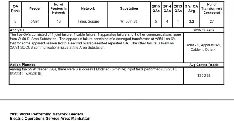

However according to reliability reports, it appears that Time Square Network is fed via 50th st.
Anyone know if it was transferred over to another substation or has feeders from other networks? 50th also has the Hudson network, but it looks to have gone down. I'm beyond words confused.

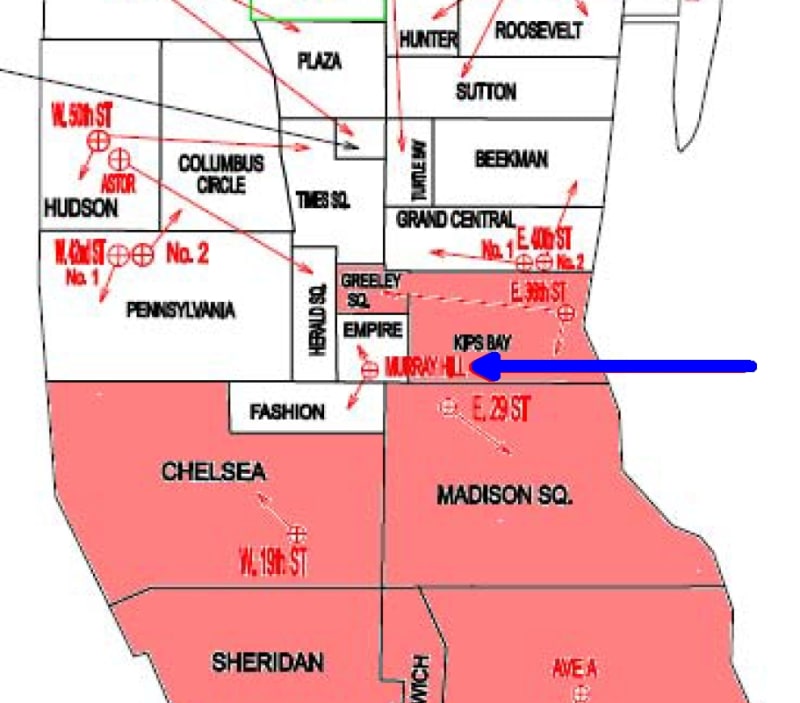

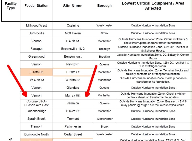

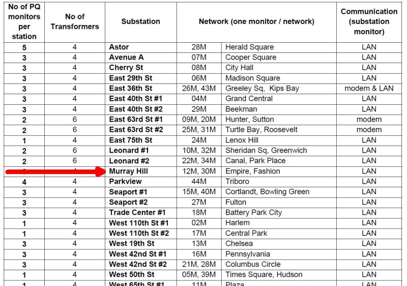

Here is Murray Hill supplying Fashion and Empire at the time of Hurricane Sandy.
Networks supplied by Murray Hill in 2015. The number of transformers mentioned in the table are those with PQ monitoring, not the total number in the substation or network.

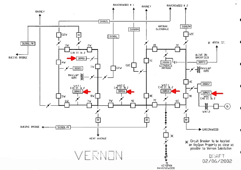

Murray Hill fed by Vernon at the time of Sandy.
The blue line represents 5 138kv feeders originating from Vernon supplying East 40th st and Murray Hill substation.
If wondering Queens bridge takes 138kv and steps it down to 69kv with 7 69kv feeders supplying East 63rd st.
The Vernon double ring bus, which interconnects generation to the 138kv transmission system in Queens.
38M01, 38M03, 38M04, 38M05, 38M06 feed out to 40th st and Murray Hill.
My guess for the numbering (missing 38M02) is that at one point 7 69kv cables fed out but were upgraded to 5 138kv cables.
If I have it right 38M72 is no longer "capped off" (alive on back-feed) but connected through a phase angle regulator were some power can be exchanged between West 49th 138kv and Vernon.
FWIW, somewhere in the late 2000s 38M72 was connected to Vernon via a phase angle regulator.

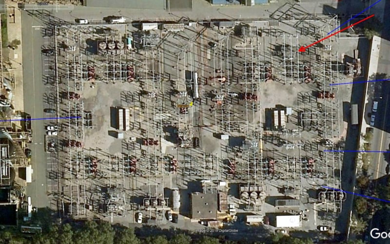

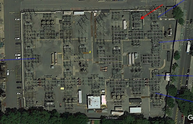

Vernon substation showing the 38M72 phase angle regulator (quadrature phase shifting booster) at the top right.
A 2006 picture of Vernon without the phase angle regulator present on 38M72.
Con Edison did the right thing and replaced the maroon colored breakers with SF6 breakers.
The 3 round cylinder with radiators on some outgoing lines I believe to be iron core current limiting reactors.
