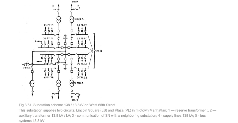

To sum it up the West 65th street outage should not have spread (resulted in 5 138kv feeders going down) even if all 5 or 10 transformer protection relays at 65th called for trafos shutting down.
Take a screen pic of those stations, I can immediately tell you what is what.
What prompted circuit switchers being installed at Con Edison area substations was a fire at the Seaport substation in 1990. The transformers could not be shut down without de-energize all 5 138kv supply feeds. Unfortunately when those were de-energized, so was the trade center substation which also takes taps off those 5 feeders.

Old thread- but thought I would add this to the archived history. West 65th st in an old Russian Engineering book. Note that are some translation errors and age based discrepancies.

The 6 transformers on the edge feed the load until the one in the middle needs to carry load to perform maintenance on one of the perimeter transformers.
You were correct, One of the Five is what I call a "hot spare" as mentioned by the NERC PDF regarding the incident.

NERC released a report. It looks like EM relays were involved and missing wires in the CT circuits.
From what I gather it looks like 65th st did not have circuit switchers installed at the time of the incident which would have greatly "contained" the outages. Either that the trip signal spread further than it should have but nothing is mentioned in the NERC report in regards to circuit switchers.
