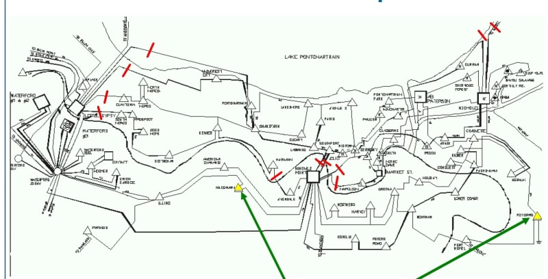

A major transmission tower structure appears to have collapsed into the Mississippi river blacking out all of New Orleans/Orleans Parish:
Reports indicate this to have been a vital power path-
A statement from Entergy says they lost 8 transmission lines which resulted in an energy imbalance causing local generation to trip off line:
Any more info welcome, as well as thoughts on what may have gone wrong and how to prevent this in the future.

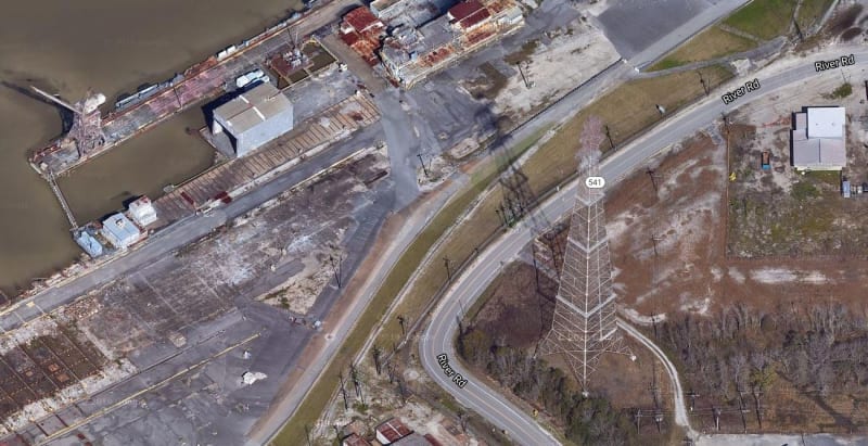

Power line drive at the river showing the tower,
Turn the view around, and see the this anchor structure It looks like a two circuit crossing, but it really is only one.

Tower on the other side of the river
This is an impressive river crossing.
