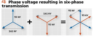

6 phase circuit on single tower
So Far only a few installations. Reported to have some advantages in limited rights of way situations.
Revisiting Six-phase Line Transmission
Attached
Performance Evaluation of Six-Phase Power Transmission Line With Limited Right-Of-Way

The article I cited above describes a line with 6 phases with 60 incremental degrees phase rotation.
5 phases brings to mind 5 conductors with 72 degree rotation between phases. That would be a seriously complicated transformer winding.
To support N-1 the line could be fed from two transformers - with the line sides 60 degrees offset. These transformers are all made on order, so there should not be much cost difference, and substations likely to be connected to lines like this always have transformers in pairs (at least here).
The towers could look like this if the line need to be compact and have minimum possible EMI or conventional 6 poll towers could be used.
