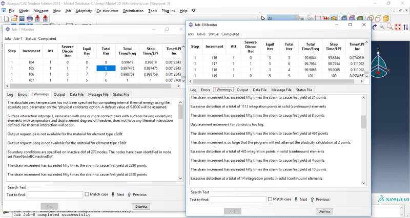

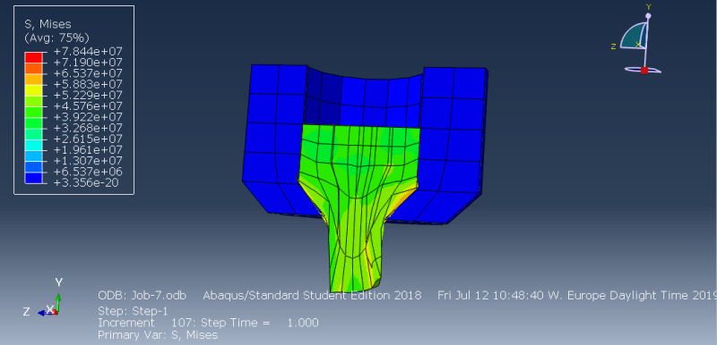

yes But I didnt get good flow. You can check here. When billet flows down it strikes to nozzle and distortion inside nozzle.
I already put viscosity but error comes and abaqus/standard its not possible.
I need some smooth flow and I didnt find good data for plastic like yield stress and plastic strain. I have already applied data but it comes with warning.
I dont know how to solve this problem. If you have some idea then just share with me.
So here you assume that polymer during extrusion is a solid elastic-plastic body and when it is extruded it undergoes large plastic strains. This approach could be used for metal extrusion but in case of polymer you should rather use CFD and perform an analysis like these shown in the 3DS Academy project called „Polymer Extrusion”. You should find it easily on their website.
I have tried with CEL and SPH but this are used for pure liquid. In my case its semi liquid. So I have to try something new. do you have some idea how can I solve this query?
I agree that polymer during extrusion is somewhere between solid and liquid. However for the purpose of the analysis you have to decide which of these two types of matter you will simulate. In this case you are interested in the flow so I suggest treating this material as highly viscous fluid (Carreau model is often used) instead of modeling it as a viscoplastic solid. Such approach is also used in the references I’ve mentioned in the previous post. If you search for more articles you will find out that CFD is standard tool for the purpose of such simulations.
