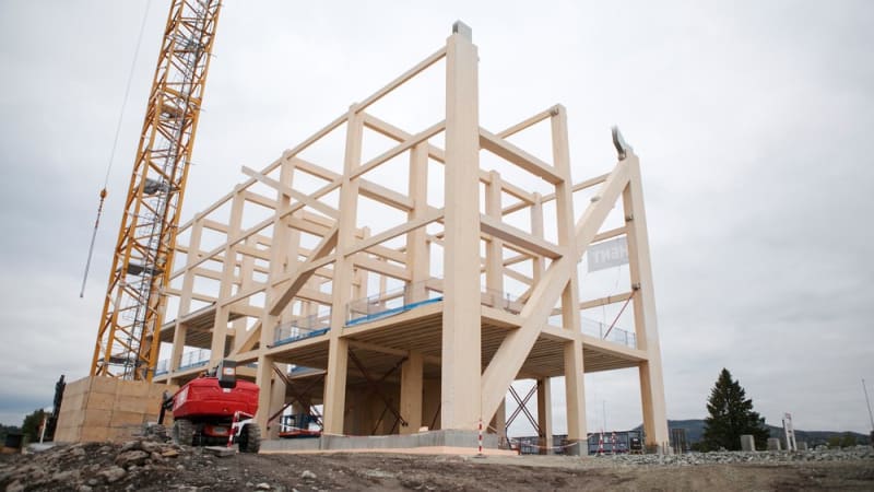

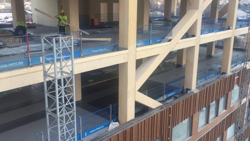

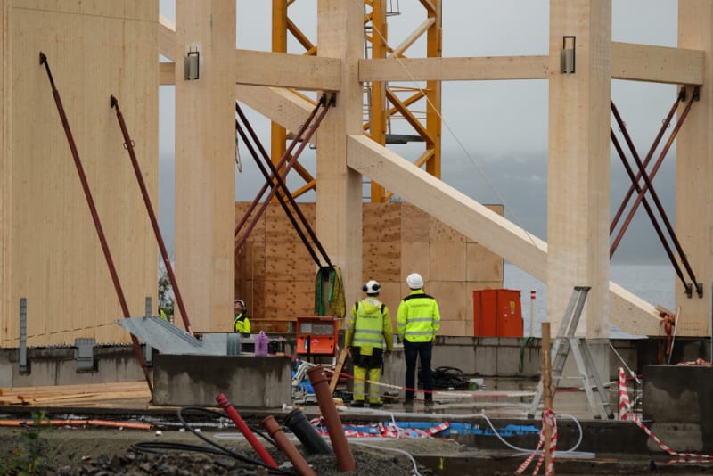

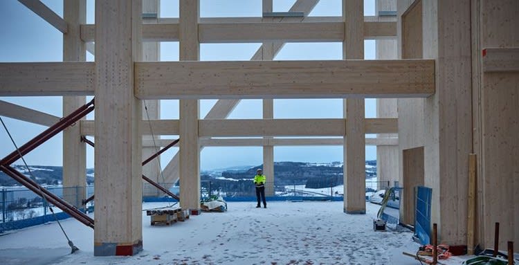

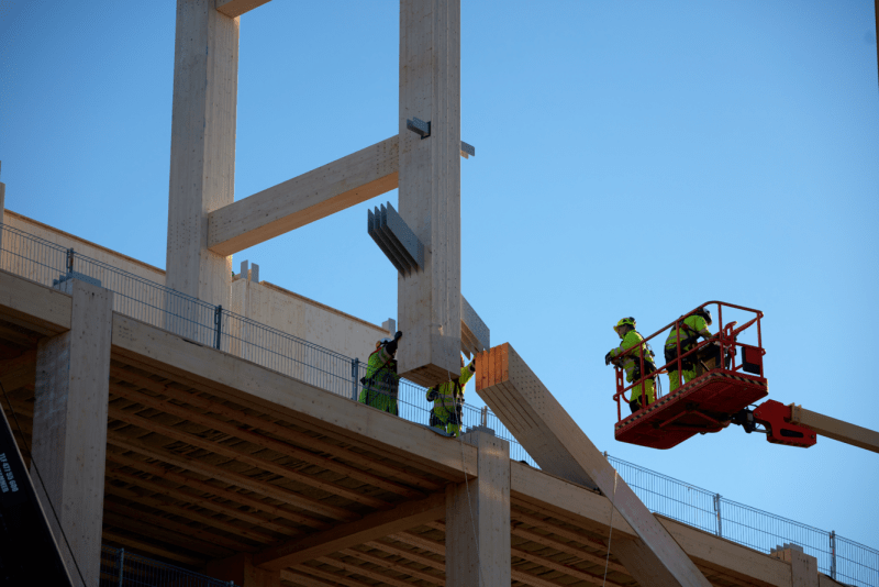

A web search for pictures during construction show massive glulam columns, beam and braces with hidden embedded steel plates with lots of holes. Pretty interesting, but not my cup of tea.
Simply awesome. there were challenges with the vancouver "brock commons" 18 level CLT building, but the lateral system was simple and conventional concrete. a timber lateral solution for an 18 level building is cutting edge.
