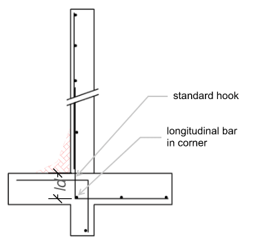

Here's a sketch of the bar I'm referring to, I'd like to minimize the development length 'ld' of a standard hook using a longitudinal bar in the corner
No. That would not reduce required development length. You'd have to develop it with the other bar for the other bar to help, which just puts you back where you started.
Thanks pham, that was my suspicion.. no go for a standard hook
But aside from what the code allows for a standard hook, could I develop it like a stirrup hook? If so what's the biggest stirrup bar dia permitted? If not, why not?
I think it should be added as a factor for std hook dev length in ACI 318, can we just vote for that here? ;)
This isn't actually a development length problem. It's a "transmit the bar tension around the corner" problem which is usually less onerous in terms of footing depth. See this thread for a ridiculously exhaustive discussion of the issue and a bunch of strategies that you might use: Link

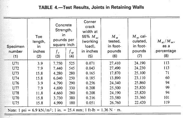

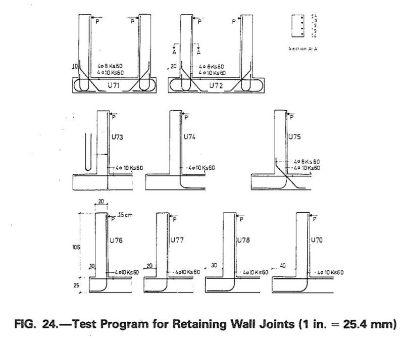

1) STM isn't the only design method proposed in that thread. Far from it. STM is just a useful way to discuss the problem. There are efficiency tables based on testing and that is probably what I would be inclined to use for something like this.

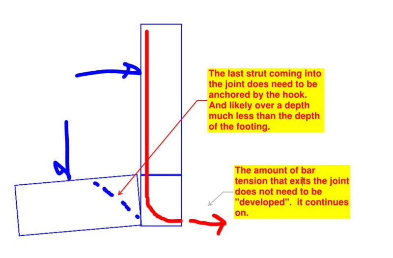

Getting deeper into the weeds, it's actually a hybrid as I've shown below.
It's "around the corner" with respect to the toe and partial depth bar anchorage with respect to the heel.
I appreciate the clarification, and the test results are compelling. I'm glad to see U70 performs as designed, as I've seen that used most commonly.

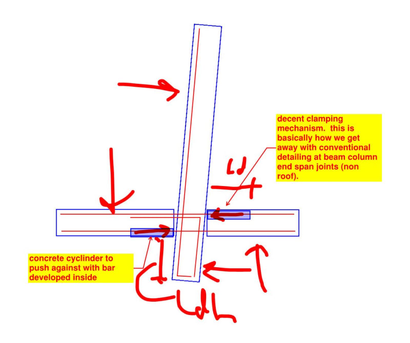

Sort of. That, fully acknowledging that, whenever I think that I've found a loophole, it almost always turns out that I haven't and that there is a "reason everybody does it the way the do". I'm afraid that all of the other engineers are / were pretty sharp cookies and they've not left many valid openings for better mouse traps.
The first thing that I'm usually trying to get rid of is the key. If you're stuck with the key already, however, it does afford an opportunity as I've shown below. This will make for a pretty good joint. You might get a modest reduction in footing depth which will be at least partially offset by the need for a bit more rebar.
