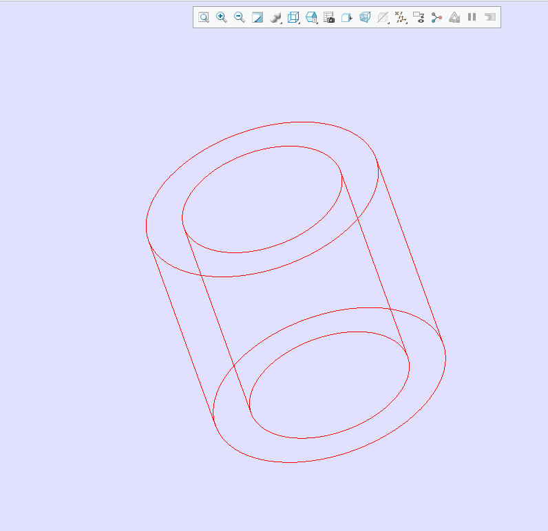

I have attached a screenshot of a simply cylinder to illustrate the problem.
I have tangent lines set to solid, yet when I view my models in wireframe or hidden, the tangent lines are invisible.
Any tips?
Thank you.
You have not attached a screen shot - use the Image button.
I found the solution.
For whatever reason... the new company I am at has this configuration setting set to "NO" as default.
The team here is new to Creo so they probably didn't recognize that something was out of place having never known otherwise. Happy ending :)
