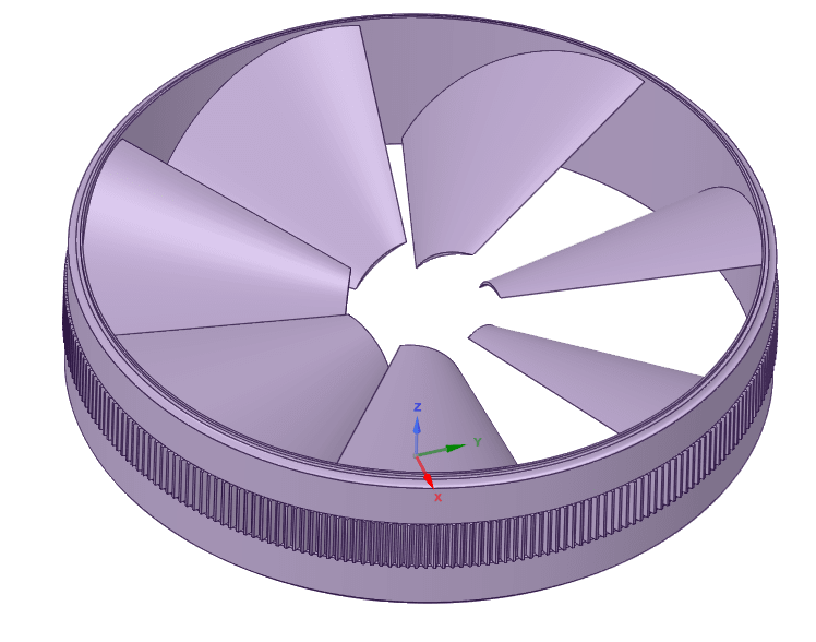

What methods are possible for "bearings" for a 120mm diameter x 50mm rim-driven, HUBLESS rotor?
Mass: ~128.5g
RPM: 2000-3000
Forces:
Radial: its own (well-balanced) mass x angular velocity.
Axial: ~500g in one direction.
Note: Besides the ludicrous costs, stuff like this is excluded because of weight.
Looking for ideas, possibilities...

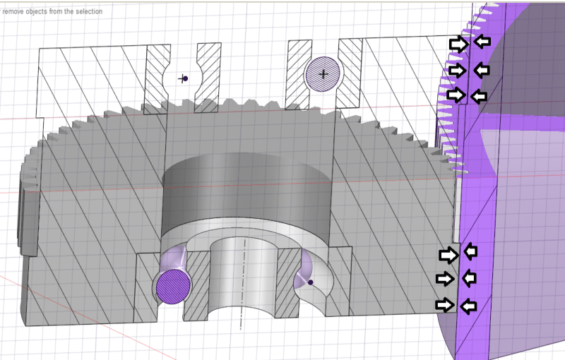

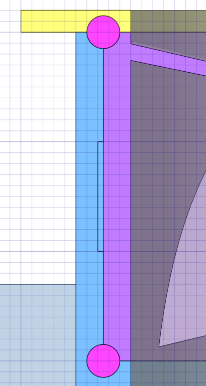

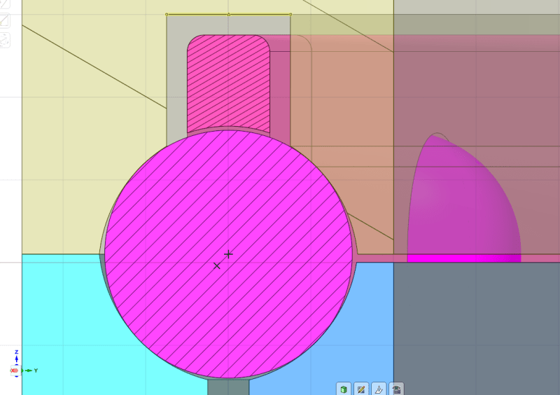

Purple is the rotor; blue the body in which it rotates, yellow the flange that retains the upper bearings:
An alternative possibility is to use 'rod' spacers something like this:
Hollow to cut down inertial mass; smaller diameter than the balls tro prevent rubbing in the race;
ends shaped to be a close fit to the balls so that they 'float'.
Problem is that the tolorance between too tight--can't move and too loose--rubs everywhere is very small:
And they are a pain in the butt to print.

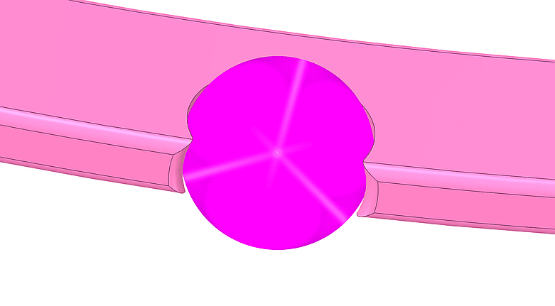

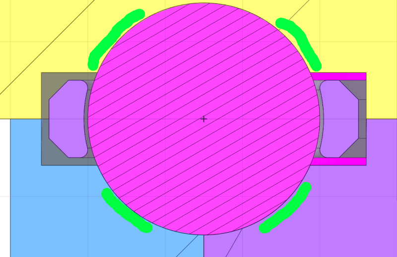

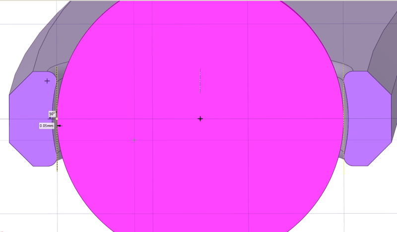

I assume you mean something like this:
Let's look at that idea in detail:
In order to support the load both radially and axially, it will be necessary to retain material in the raceways at diagonally opposed areas as highlighted in green above.
And that places an upper limit on the thickness of the cage, so it ends up looking something like this:
Can you see the problem yet?
If you make the clearance sufficient to prevent high friction in use, the hole is too big to retain the balls.
0.05mm (a gnat's under 2 thou if you are of that persuasion). I cannot 3D print any tighter.
And if I could, how would I get the balls in to the cage?

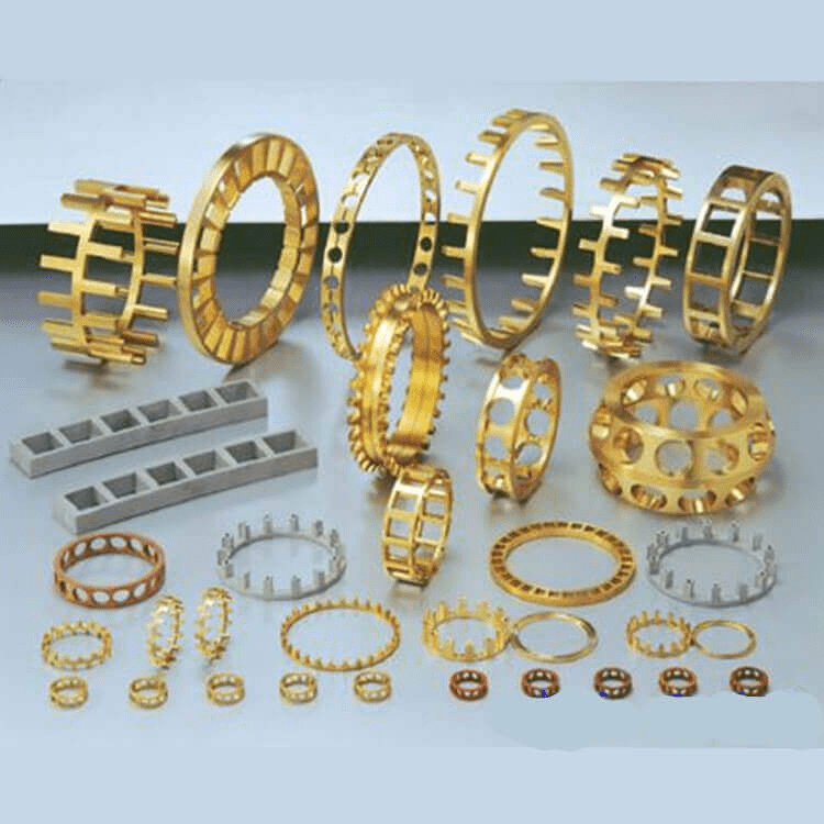

I guess if I had the equipement at home to produce a 2-part, pressed phosphor-bronze cage and rivet them together something like
I might be able to make it work; but I have to live in the real world where 3D printing a 1mm thick, 4mm wide, 120mm diameter ring like this fraught with problems:
Even if I could make the hole tolerences tight enough to retain the balls, the idea that I would be able to get something as large, thin and delicate as that to print correctly is inconceivable.

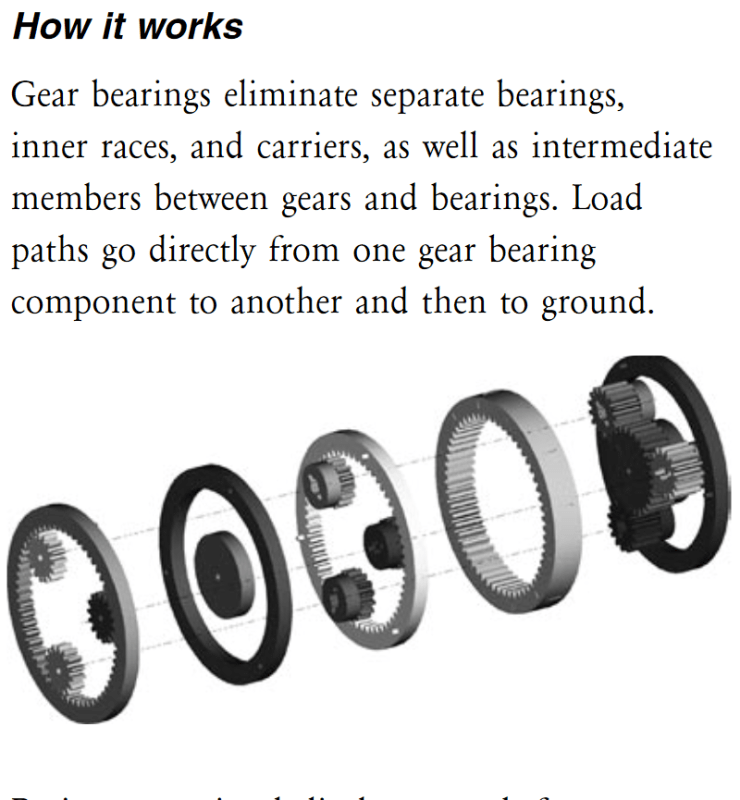

Before you go off half cocked though, take a look at this NASA licencing page for their patent for "Gear bearings".
An extract:
Know that these have been implemented in many satellite's -- some you might have heard of; many you will not have -- reaction control mechanisms.
I know, because I designed some of them.

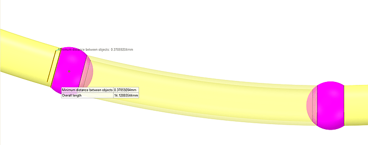

You can likely get away with a wider cage than that; I'd start with a cage width of roughly half the ball diameter. Remember that your radial bearing forces, assuming your rotor is well balanced, are going to be pretty low.
You don't need the cage to retain the balls; you need the cage to keep the balls evenly spaced. That's it. Can't 3d print it? Buy a sheet of 1mm PTFE and cut it by hand. There's solutions out there. Everything in the world cannot be 3d printed.

I'll say it again.. you don't need the bearing cage to retain the balls. All it has to do is keep them evenly spaced. It can be very thin, although it doesn't need to be. It also doesn't need to be 3d printed. Buy some PTFE sheet and an xacto knife and with some careful work you have a prototype bearing cage in about an hour, maybe.

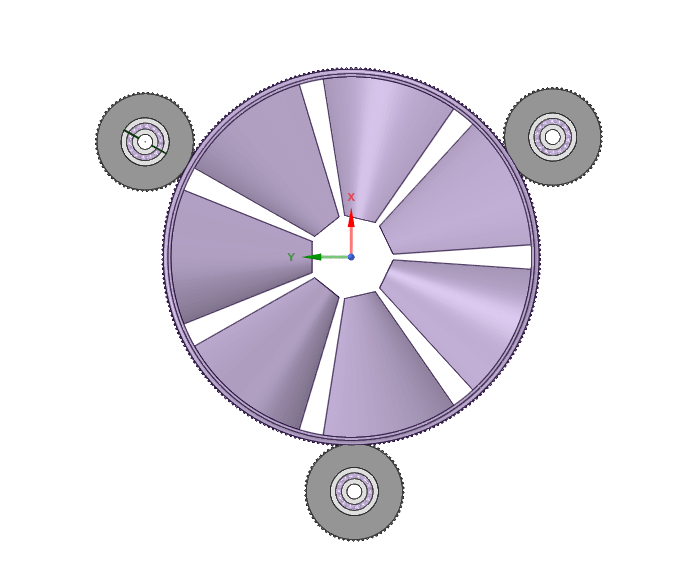

That doesn't happen. The rotor is located radially by the bearing surfaces above and below the gearteeth (as arrowed in this two-plane cross-sectional view):
which ensures that the teeth do not become wedged into each other.
Three of these gear bearings at 120° provide 6 points of radial location:
Two of these are undriven, and the teeth only serve to ensure a non-slip operation.

SwinnyGG: "you don't need the bearing cage to retain the balls. All it has to do is keep them evenly spaced."
If the cage is not centred by the balls, then in addition to the friction from the small areas of contact between balls within the cage holes;
you also have full circumference drag between the face of the cage and the raceway.
SwinnyGG: "Buy some PTFE sheet and an xacto knife and with some careful work you have a prototype bearing cage in about an hour, maybe."
Have you heard of PTFE creep?
Within minutes of operation, the holes will elongate, the edges of the holes in the direction of rotation will be skwished down to form ramps, and the balls will ride up and the whole kit & kaboodle (industry term) will jam.
There are filled-PTFE (Glass fiber; Molybdenum DiSulfide) alternatives that resist creep, but trying buying sheets of it! (And you wouldn't be engineering that with an Xacto knife.)
And other polymers that might serve teh purpose, but they would need proper engineering and I don't have that capability.

SwinnyGG: "You could also turn the whole arrangement 90 degrees, if it makes it easier for you to package."

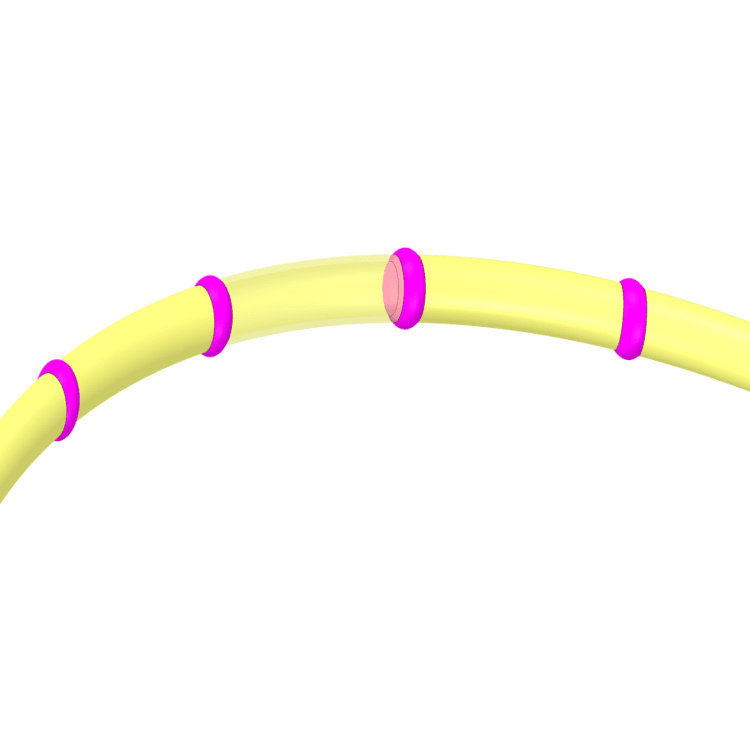

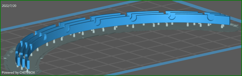

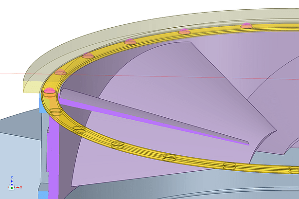

I kept dismissing this on the basis that it created more problems than it solved -- and it does if I distribute the cage equally around the balls -- but the notion struck that I don't have to do that.
By distributing the cage asymmetrically around the balls, it should give me enough flexibility to snap the balls into place and make them 'captive' without requiring them to be a tight fit;
and by arranging the cage vertically to sit on top of the balls, it will ride on top without touching the races; even if I cannot make the balls actually captive.
Further, I can split the cage into 3 or more pieces and print them flat on the bed of the printer:
So thank you for persisting!
