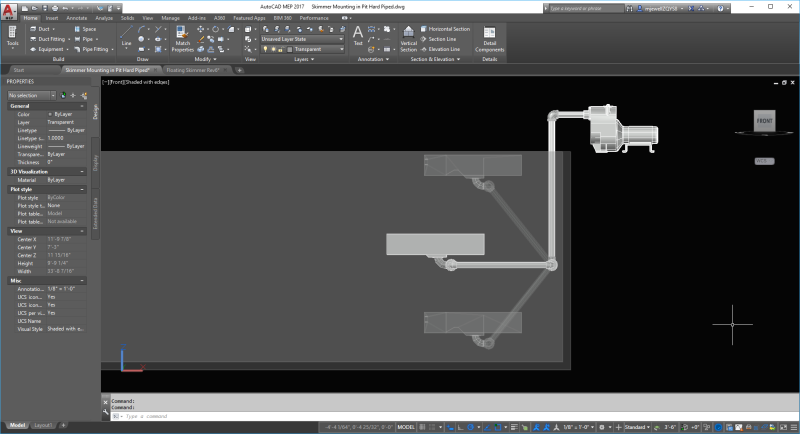

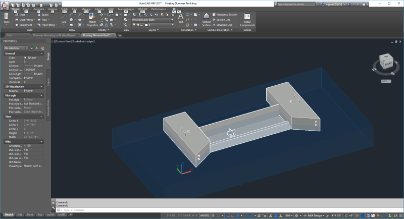

I am designing a floating skimmer that will draw off the top 1" of fluid in a pit. The skimmer has a sump that will hold ~4" of water (total volume of ~5 gallons). The suction line is connected to the bottom of the sump. The pump suction line is 2 inch schedule 40. My operating point on the pump curve with the pump I plan to use (using my estimated system curve) will be about 100 gpm. Using submergence rule, I should have ~6 feet of water to prevent air entrainment due to vortexing. I put a small vortex breaker at the suction line inlet, but have no experience with actual design of a vortex breaker, so I have concerns that I may still get air in the suction. I attached some images to show my current layout and design. CFD isn't an option to confirm the design. I've read some older threads on here and some articles online and think I have some basic direction I want to go. That said, anyone have any tips on avoiding air entrainment or vortex breaker design?
Edit: also want to add that the pit is open atmospheric and the fluid is water typically 70-95 degreeF.

Not sure what a PD pump will get me? I plan to use a self priming centrifugal, but whatever pump type I use, to get the flow and head I need, I end up with high suction line velocity. I could go with much larger line size but there are cost and weight penalties to that. The velocity is what causes the potential for vortexing. I believe I can avoid the vortex with a breaker, but have never used one in any application.

I also have an alternate design where I use a 6x2 reducer on the bottom of the skimmer. It adds 5.5 inches of height to the skimmer, so it limits my low level ability. I'm also not sure it would stop the vortexing, it may just move it a little further down the pipe.

Using the chart, velocity needs to be right around 1 ft/sec for 4.5" of water depth. I can obtain this by using a hat style vortex breaker (see below). If I size it to be 4D and locate it D/2 above the suction inlet, the annulus area will be 24.632 in2 (.171 ft2). 0.2222/0.171 => 1.3 ft/sec. I can adjust the dimensions of the hat to get the velocity down more. I believe this has the same effect as putting multiple connections and manifolding them together.

I could go larger, but it adds weight and cost. Even at 3 inch, I am still prone to vortexing in this application. I may look at some additional configuration with in the sump to slow velocity and/or make the transition better. Possibly replace the first elbow suction elbow with a mini sump (maybe 4x4 or 4x6 cross section) to give additional space to accelerate the fluid.

what about a secondary sump within your initial sump and a horizontal plate at the end then draw off the liquid at both ends of the second sump horizontally in a 3" pipe and join both up before going up.
