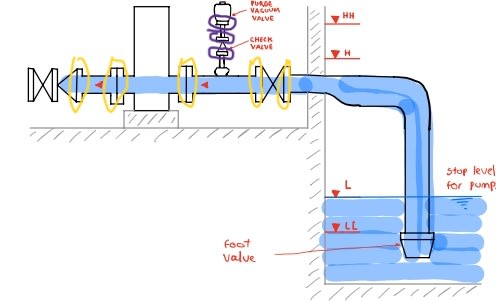

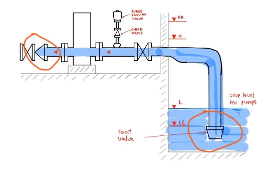

Hello everyone,
I’m evaluating cost effective proposals for a flood control pump system that also allows for convenient maintenance. One option is to install dry vertical non-self-priming pumps next to the wet well. The pumps would start with a water level on the wet well above the suction line of the pumps and would stop with a water level beneath the suction line of the pumps.
For priming the suction, I’m wondering if anyone has tried implementing a purge valve downstream of a check valve, allowing the system to purge the air as the water level goes up, but retaining the vacuum during pumping whenever water level is beneath the suction line of the pumps.
I’m attaching a drawing for clarity. Consider that NPSH has been verified. Other elements on the line include a foot valve with strainer and a check valve on the discharge, since another concern is keeping the suction flooded. Any advise or proposals are welcomed.
Thank you.

OP,
I feel an initial statement is counter to your proposed design.
I’m evaluating cost effective proposals for a flood control pump system that also allows for [highlight #FCE94F]convenient maintenance[/highlight]
By your design, you already have two check valves to hold prime, so I would wonder if adding the adding checks and purge valves needlessly adds complexity to the design, on top of reliability and maintenance considerations. Maybe I am missing something, if so, please clarify if you'd like.

OP,
Let's consider this another way. Vacuum leaks on primed lines are a very common problem and there are plenty of topics here discussing the issue, so one method to reduce the chances of this happening, is minimizing leak points. Consider common leak points being pipe fittings and check valves and rest assured, check valves will eventually leak.
In a configuration without the check and purge valves, you have 5 possible leak points from pipe fittings and 2 check valves inline, so you actually have a little redundancy with the two check valves, but they can still be points of failure.
In your proposed configuration, you have added 3 more leak points from pipe fittings and even though you essentially have 2 additional checks in line, you have added them in an additional leak path.
If your only goal is to assist in initial priming, then all you need is a block valve.

I don't really understand what the issue is here?
ON pump start you have flooded suction. All you need is an air release valve where you place the "purge vacuum valve".
Ditch the foot valve, you don't need it as you have an NRV in the pump suction. Who cares if the suction line empties? When the water level rises above the suction line before the pump starts, any air will be vented out of the air release valve.

Ok, thank you all for your advice. I will continue to look into the vertical turbine pumps and submersible options.
As for the initial option for the dry well, the idea of considering vertical pumps is to reduce the horizontal footprint in order to reduce as much as possible the area required for the dry well and also to be able to uncouple the piping to hoist the pump.
Also, I’ve found some manufacturers that can provide purge valves with the option of including a non-return function to maintain the vacuum when the water level is low.
