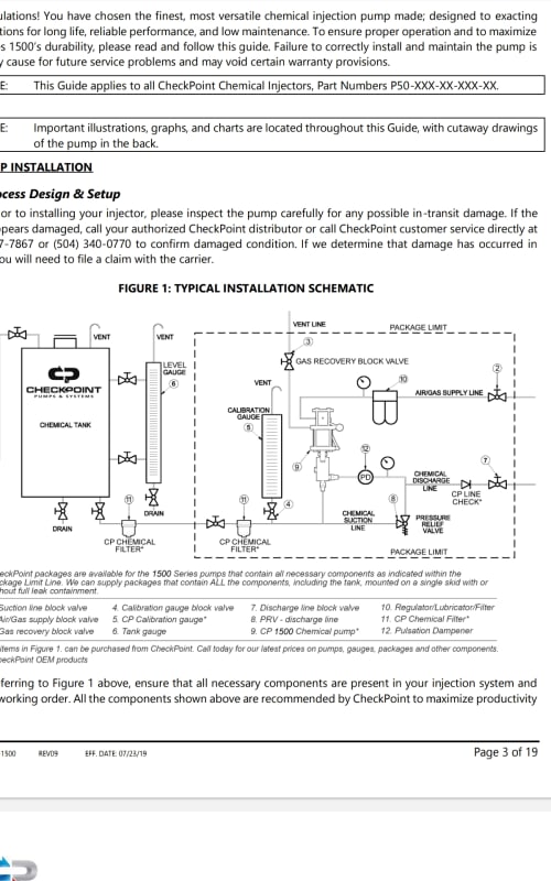

IMO, the spillback of the injection pump is typically routed back to the tank without any concern. The return line of the 25ft head shouldn’t be the issue for the pump discharge.
Since total injection rate will often be less than pump throughput capacity, pressure spillback should be to source tank, not into pump suction.

Typical installation is
From
If it is going to involve considerable effort to connect this pressure recycle to source tank, it may be possible to return this to pump suction provided :
a)fluid saturated vapor pressure (or bubble point pressure) is much less than minimum suction pressure at say 10degC higher than source tank temp
b)pump is stopped on auto sequence when there is no net forward flow to consumers.
If you dont know bubble point pressure info for the chemical being injected, route pressure recycle to source tank.
