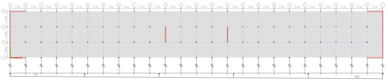

I’ve searched high and low for an explanation, but can’t find anything on google or the CSI docs. I have a few questions regarding User Defined Wind Loads and diaphragms (manual tabular input of Fx, Fy & Mz at a coordinate at each level).
How does ETABS distribute User Defined Wind Loads around the semi-rigid diaphragm?
How does ETABS choose what joints to apply the components of the diaphragm forces?
How are the “Reactive Forces” calculated?
For example, shown below is the user defined wind point load (including torsion moment) for a particular level applied at the centre of rotation (COR). Red is the slab outline and blue are the cores.
After running the model (which has no major errors), the user can display the diaphragm forces as either the Applied Loads or the Reactive Forces.
Is ETABS smart enough to distribute the point load around the joints of the diaphragm, even if the position of the point load isn't on the diaphragm? From what I understand, ETABS internally creates a special joint that is used for the application of this point load.
My understanding is that it lumps the single load on the centroid, so basically it's incompatible with a semi-rigid diaphragm. I've seen many a people who come unstuck on this point during peer reviews, all the load goes to the closest vertical structure, but they don't pickup on it.
You are better modeling the wind by applying a horizontal line or area load to the diaphragm as this better captures how it's applied in reality (spread across the width of the building).

Well some of these have been mentioned above
1) This should not be done with semi rigid diaphragm as is completely unrealistic assumption, the load will be lumped at the closest node in the floor, a lumped concentrated load only makes sense with rigid diaphragms, for a semi rigid, you should distribute the load . This is what ETABS does when using auto wind loads with semi-rigid diaphragms
2) Lumps it to the nearest node from the point you have specified
3) Just as the reaction at those nodes from floor to walls/column, again this may not make any sense for a semi-rigid diaphragm with a user load.
Update:
After speaking with colleagues and CSI directly, ETABS doesn't distribute/smear user defined wind loads as described in the original post. It does however having a smearing algorithm for auto-generated lateral loads, it picks 10 joints of the pre-analysis mesh (ie corners of slab, wall ends, columns) that it applies forces to in order to replicate the resultant horizontal forces and torsional moments.
I think it would be a very handy future feature, to distribute user wind loads to a semi-rigid diaphragm in a similar manner that it does for auto-generated loads. Any project with a wind tunnel report will provide loads in a Fx, Fy & Mz format.
