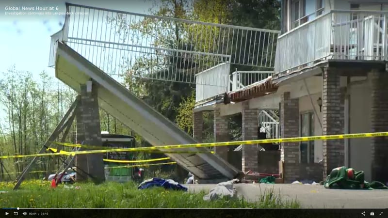

The thing looks flimsy. There is no mention yet if this is the work of a contractor or a home handyman.
JHG
At least no one was killed. Looks like a job for Holmes & Holmes.
Global News - Police investigating...
So it seems this house is used as a party rental. I hope the owner has a proper business license and insurance. The renovator surely didn't have a building permit.

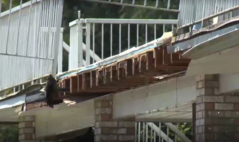

From the photos, my guess is that the protruding portion of the deck was enlarged at some point in time and the framer just scabbed onto the stub outs with a boxer.
Given the very clean cut ends we can see it would appear as if the box frame of the stub out was simply attached to the ends of the beams. The centre beams seem more damaged and maybe rotted first.
Workout more detailed photos difficult to say.
Those strange angles holding up the brick piers look like later additions to prop up or stiffen the extension?
I'm wondering if the wooden props were added post-accident to preserve the scene.
A.
Not with the metal tie which goes from the base of the brick pillar to the midpoint of the prop.
Looks original to me.
