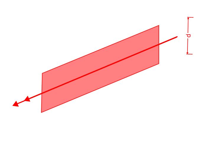

This is something that has been driving me nuts for some time, as I could never reconcile polar moment of inertia with the formula presented in the code. I've sketched out how I think it should work for a center and edge column, and I'm wondering if anyone agrees with me. Hope this is of some use to someone searching for this in the future as well.

The middle term in ACI appears to be the "I.y" of line being considered, so I think it sticks around no matter what
But why is the I_y component relevant for uniaxial moment? What is its physical significance to the stress distribution?

Well, neither the I.x or I.y components appear to have a physical significance to moment distribution, so I normally just ignored them when calculating J.

I see what I missed on the side face. And the maximum stress in the corner from a usual polar calculation is ignored with the stress assumed constant (or averaged) over the depth.
