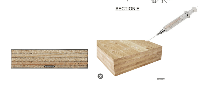

This should probably be it's own thread, but why is so much of what I see on LinkedIn mass timber related now? It's odd and I'm not sold. Is it really The Future like they all claim?
It's because innovation in structural engineering happens at a glacial pace. Mass timber is the first new development since Newton rocked our worlds. Everybody wants to pile on for marketing purposes and show their architect clients that they can deliver the "sexy" that is a warm feeling, environmentally friendly, exposed ceiling.
Fire schmire. If you gotta die anyhow, why not die in blazing inferno that makes you feel woke and closer to nature?
Thanks for the laugh. I've noticed the mass timber folks are very sensitive and defensive (perhaps necessarily) in regard to the fire problem. I've seen some very interesting comment sections on LinkedIn about it... I've only set foot in one mass timber building and it sure was pretty and one of the nicer places to meet my maker [tongue]
Humor aside, I'm a fan of mass timber. I'm a native son of British Columbia, the epicenter of that world, so I kind of have to be. A lot of my people derive their living from harvesting forest products.
I feel that the fire issues are mostly resolved. Yeah, it is a bit unnerving to have the bulk of a structure made from something that is considered "fuel". That said, just as with load combos and everything else, I believe that fire has been resolved from the perspective of reliability. And, really, that's the only perspective that matters (scientific method and such).
I do believe that all of the mass timber hype is over done for what is, effectively, plywood infused with exogenous testosterone. Were one to guage things based on the flurry of mass timber activity on LinkedIn, you'd think that we'd solved time travel or something.
Mass timber will get my support as environmentally friendly when they stop cladding it in glass to show it off and burn all the benefits in heating and cooling costs. Talk about virtue signaling.
