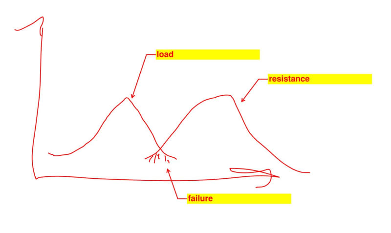

I constantly here non-engineers complaining about how everything structural engineers design is so unnecessary and overkill. It is hard to explain to someone unfamiliar with design codes and engineering theory why certain members need to be sized the way they are sized even if using a smaller member (or no member at all) would not cause the structure to fall down.
I am wondering if anyone has had any discussions with members of the non-engineering community around this topic, and how you explained to them that the seemingly unnecessary sizes of the components are indeed necessary.

I tell non-engineers what I believe to be the truth:
There's what I think works and there's what I can prove works. As a licensed professional with ethical obligations to my community, the latter is my domain.
This often leads to the "but nothing ever fails" critique. If I have pen and paper handy, I do the sketch below and illustrate why that is the case, by design. If they get it, great. If not, it often serves as a conversation ender anyhow.
Realistically, in my opinion, a prudent business person calibrates their designs to fall near the median level of rigor for local practice. The perception of "over design" is often relative to our competitor's designs, past and present.
