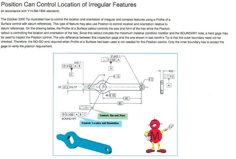

Hello,
Below is a snapshot taken from the most recent Tec-Ease tip available on their website. My question would be following: Does anyone think that the true profile between points S and T (clockwise) has not been fully defined? I am specifically thinking about close vicinity of points S and T. Thank you!
CH -- I still don't see how you can think that the 65 +/- 0.25 on pmarc's sketch could be legal. Everything you've written in your latest post is correct, but it doesn't address the issue.
To better address the issue, let's take the four pictures you just posted, and add the all-around symbol to the profile controls. Do you think that ANY of the four pictures could then have a plus/minus tolerance on the 20? According to Y14.5, the answer should be no.

To add to what you said Belanger, since the last figure (form and size) the same point would be made not with an all-around symbol but by instead switching the basic 20 diameter callout to a plus/minus tolerance since its representing a cylinder.
But yes, I fully agree with your point. The answer according to the way I'm interpreting Y14.5 should definitely be no in all four cases.

May I ask one additional question, please:
If in the embeded picture datum feature A is added in the profile callout for the HEX, what would be the additional characteristic ( if any) ( orientation somehow?) that the adjusted profile will control? Again, I am interested in the adjusted profile of the HEX (the one used in combo with the position with Boundary)
Will create any additional value if datum feature A is to be added and if yes what that value would be?
Also will create any conflict with the positional callout?
Thank you for your input.

Regarding the effect of a datum feature A reference on the hex, this is reasonably straightforward (I think). I would say that this would refine the orientation of the hex. Specifically, the zones for the hex surfaces would be oriented to datum A - this would limit how tilted any of the 6 surfaces could be (within 0.1). This would not conflict with the positional callout.

Thank you very much for your replay. So, if the same datum feature A is added in the profile callout in fig 8-24 (Y14.5-2009) then this would NOT refine the orientation of the shape, correct? That is because profile tolerance in the 2009 standard picture (8-24) is bigger than the position. Will coarsen it? Is that even possible?
Is my understanding correct?

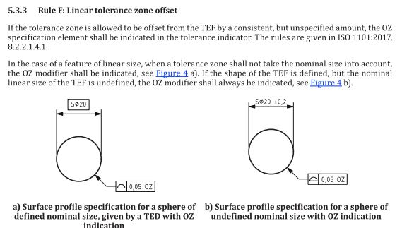

So below is a snapshot from the latest version of ISO 1660 standard "Profile tolerancing" issued in 2017.

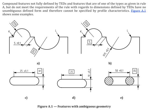

Another shapshot showing what Rule A in that document is:
The interesting part of it is the last sentence - they allow application of profile tolerances to features of size controlled with directly toleranced dimensions, as shown below, but then the profile tolerance value always needs to followed by OZ (offset zone) modifier:
Sometimes I wish Y14.5 contained some examples of bad dimensioning and tolerancing practices that should be avoided to avoid ambiguity. That would sometimes make life much easier.

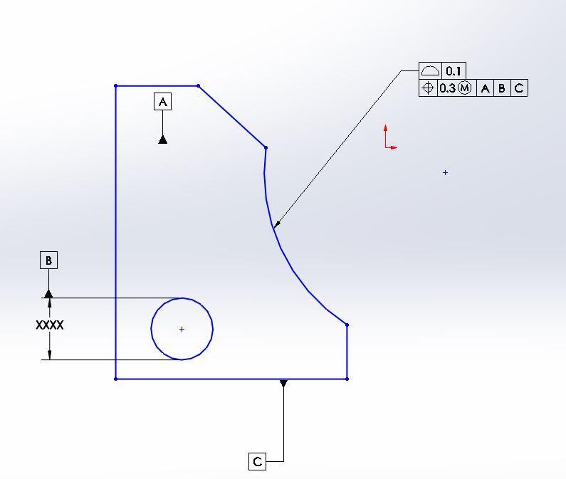

Could you please let me know what do you think about the following datum scheme:
Is, in your opinion, the intent of the standard to allow this?
Datum feature A: flat back surface, controlled with flatness
Datum feature B: hole, defined for size with ± and controlled with perpendicularity to A
Datum feature C: lower surface, defined with profile to A primary and B secondary.
Part defined with basic dimensions: basic distance from datum feature C to the hole in the center, basic radius for the feature controlled with profile and position combo, basic angles, basic length, basic width.
Question:
Is the feature shown with profile + position “combo” correctly defined per ASME Y14.5-2009?
Supplier QE states: “combo” depicted above is reserved for closed shapes as shown in Fig. 8-24.
Designer stands behind his GD&T callout: his stance is that nowhere on 8.8 (Combined Controls) is specified that the shape of a noncylindrical feature should be closed and surface interpretation prevails anyway. Advantage: using MMC on the profile.
Note: Part assembled with clearance between the questioned surface and its mating component. .
One of my coworkers posted the same question on different site, but he did not get any answers, so I said, let me try on eng-tips.
What do you think? Has this scheme envisioned by the standard?
