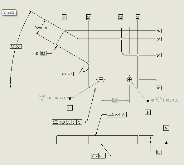

In the example pmarc showed I would think that the all-around symbol implies that the true profile encompasses the entire rectangular feature, and the toleranced dimensions applied now mean that the true profile is defined by a mix of basic and toleranced dimensions, therefore in my mind violating the aforementioned definition of true profile.
