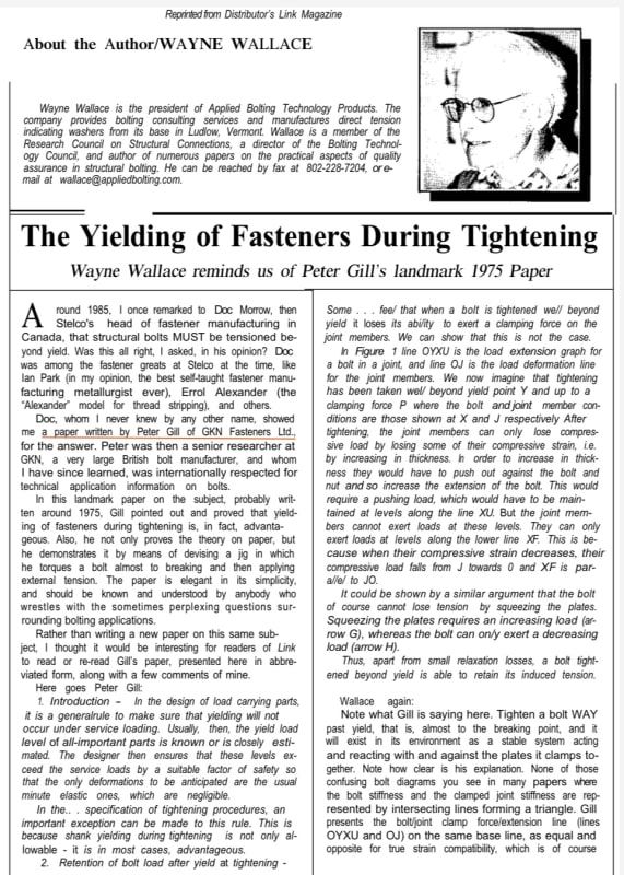

Hi
You might find this article interesting
I'm really not sure I agree with what is written there myself.
Going into the plastic Zone generally results in necking and thinning of the stud at some point and therefore must result in loss of strength as there is less square area of the bolt to apply surely?
Just doesn't make sense to me.

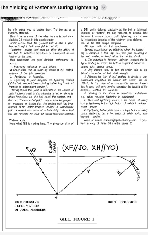

Another good article on this subject:-
The interesting thing to bear in mind is that when the bolt yields during tightening it is usually only at the outer surface of the bolt, so most of the bolt shank is still within its elastic limit.

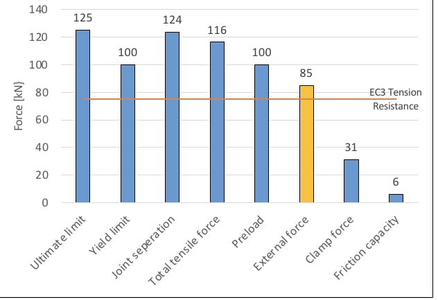

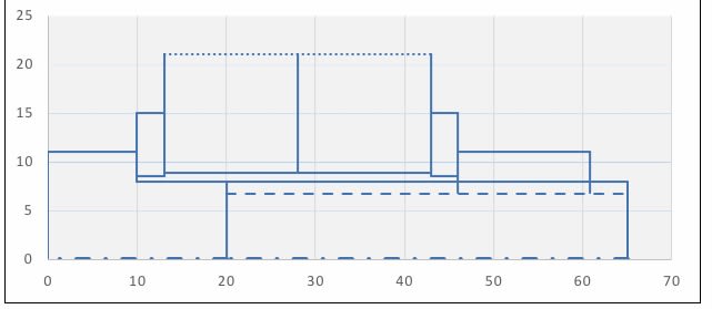

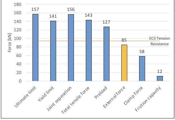

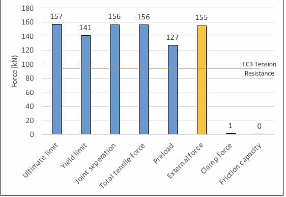

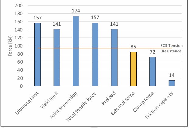

I made a few theoritically checks on excel for this case with hex.h bolt M16, grade 8.8 and 10.9, layout as below:
Test 1 with 10.9 and pretension 100% yield. Seperation is higher than ultimate, so bolt will break before seperation occurred, at an external force 85kN:

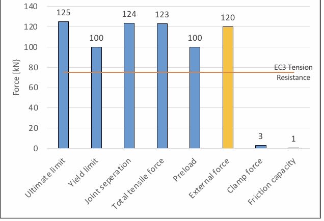

Test 2 with 10.9 preloaded at 90% yield, external force can be applied up to 155kN:
If reduce external force to 85 kN, gain some clamp force compared to fully yielded of 10.9 above:

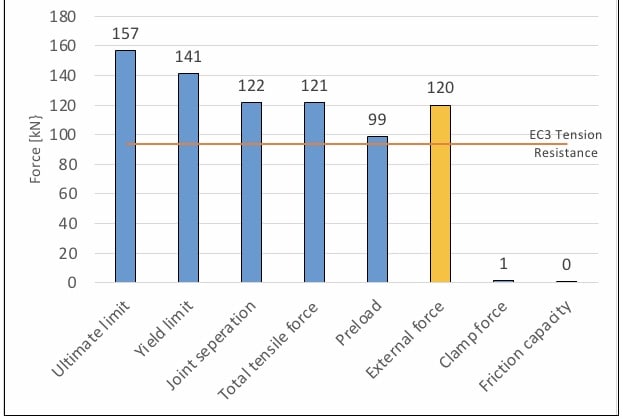

Test 3 with 10.9 yielded 70%, then 120kN external force can be applied:
If we reduce external force to 85kN, clamp force remains:

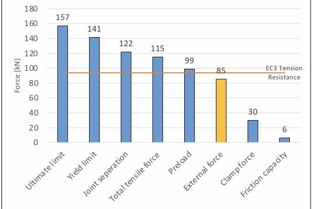

Test 4 with grade 8.8 and preloaded 100% yield. Seperation is close to ultimate while 120kN external force can be applied before seperated:
And clamp force when applied 85 kN external force:

Hi cherish
Perhaps I am reading the graphs incorrectly but I can’t get my head round how the preload can be less than the external load and yet the joint doesn’t separate until the force gets close to the ultimate load (test 4) for example
The preload is always in excess of the external load until the external load matches the preload. At that point the load in the fastener exceeds the preload.
Hi dik
I agree but look at the graphs above and they don’t reflect that.
