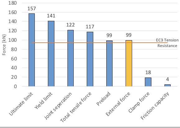

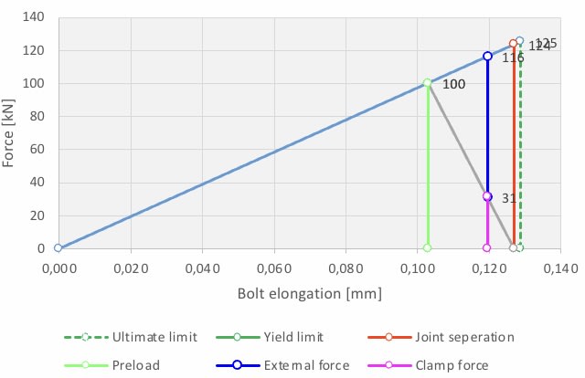

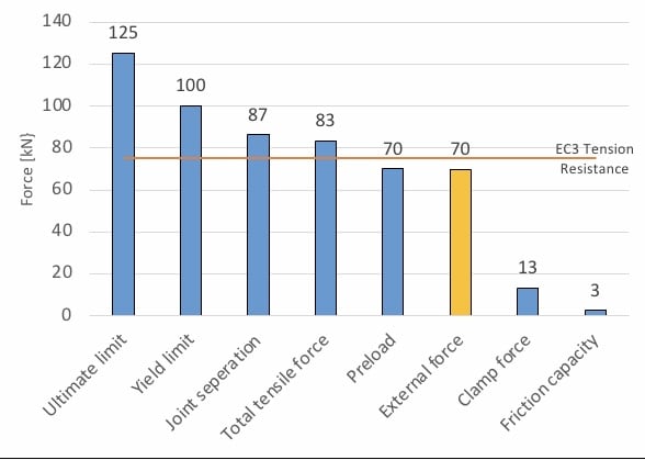

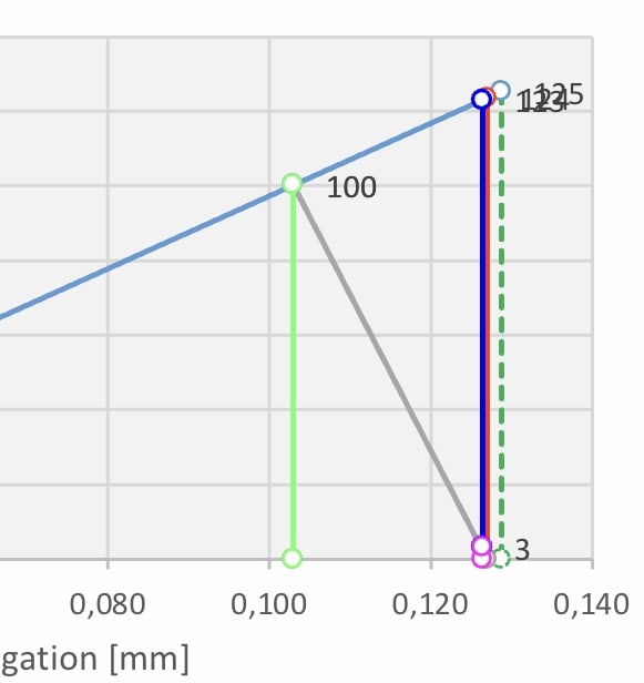

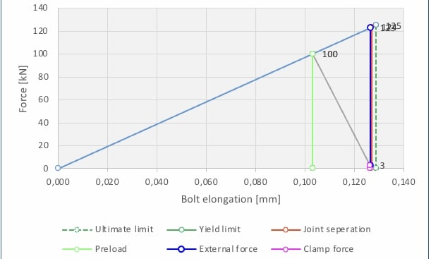

Hi desertfox,
The joint in this example has value of load sharing ratio of 0.19, so bolt will feel 19% of external load in additional to preload as long as joint is not seperated.
Diagrams of test 4 (external 85 kN and 120 kN)with a scaled view for load case has external load 120 kN:
In common sizing of bolt on the safe side and to avoid finding stiffness of the joint, limit external load maximum up to preload value is selected. However, some applications like lifting, available threaded holes can be used is quite limited and therefore utilizing bolt capacity as much as possible will need for finding joint stiffness...
In case preloaded at 70% yield for 8.8 & 10.9, with external load equals to preload:
