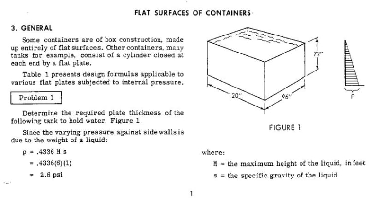

A good approach is presented in "Design of Weldments" by Omer Blodgett, section 4.6. You can buy this book for $17.50 from the Lincoln Welding Foundation, or maybe find it somewhere in digital form.
In Roark, for a simply supported plate, you have simple equations for max stress, deflection and distributed edge reaction force. Are you sizing the thickness based on stress (yield or ultimate), deflection or some other criteria (maybe a fatigue stress level)?
