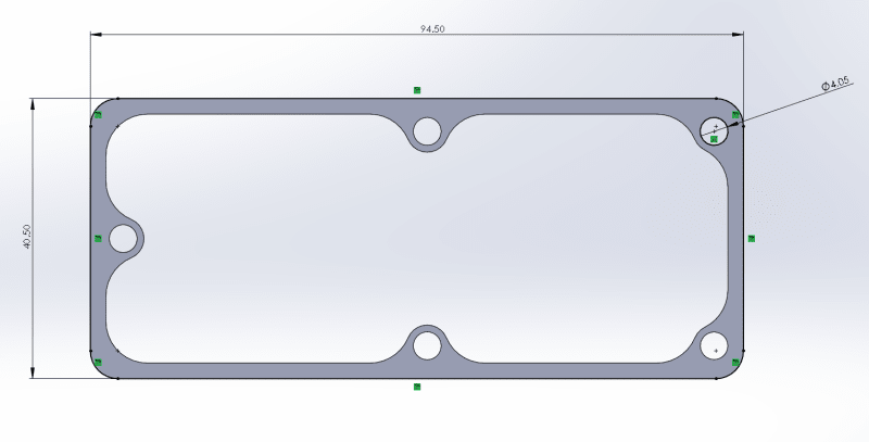

I want to ask, is there a way of a calculation for selecting the thickness of a rubber gasket (NBR rubber)?
i want to use a custom rubber gasket but im not sure what is the thickness i would need to seal the product from liquid.
Can anyone help me with this matter please?

I'm trying to seal a video camera from liquid, it will operate in normal pressure but at high temperature such as 50°C.

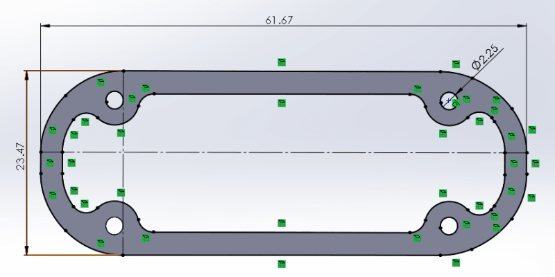

this is the rubber seal I designed, I decided to select NBR Rubber for sealing but the part I'm sealing is small as seen in the dimensions that's why I'm confused about the thickness
- will operate at normal sea level pressure
- The housing is made of aluminum
- I'm trying to seal water, like in a rainy weather.
The biggest issue with an all-rubber gasket is controlled compression. If you have some kind of standoff surrounding the holes or flange to keep the compression at a reasonable level (say 80% of rubber thickness), it should seal reliably and the fastener torques will not be compromised. The thickness of the gasket will probably be limited by available material thickness and whatever tolerance on surrounding components that will reliably produce 15-25% squeeze.
Judging by the distance between fasteners vs. the width of the gasket section, I hope this is trapped around the perimeter somehow to ensure the gasket does not distort or work its way out of the intended location.
Not using standoffs will result in the gasket material creeping and deforming without limits unless the fastener torques are perfectly suited to the compression of the rubber gasket (which in my experience, is not)

It seems that you've already designed the seal geometry without thinking about a sealing system. Too bad, that constrains your choices.
The key calculation is the relative stiffness of the cap vs the gasket. If your cap deflects by 0.02" when you screw it down, you are going to need a gasket that is able to take up that movement plus any substrate tolerance without generating too much stress. The dog bone youngs modulus of a 60A solid rubber is approx 500psi, and when poissons ratio effects are taken into account its approx 3x stiffer, lets say 1500psi.
