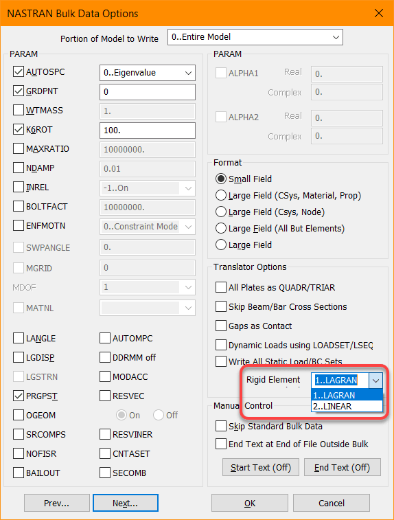

In Thermal Stress analysis models that include rigid RBE2/RBE3 elements in general this is a serious problem related with the coefficient of thermal expansion (CTE): Both Simcenter Nastran and MSC/MD Nastran support a Coefficient of Thermal Expan­sion (CTE) for Rigid Elements, but you need to activate it, check your NX CAE options.
For most Simcenter Nastran solution sequences which support this functionality, in FEMAP when defining an analysis in the NASTRAN BULK DATA this option must be set to “1..LAGRAN” to have the CTE considered for RBE1, RBE2, and RBE3 elements.

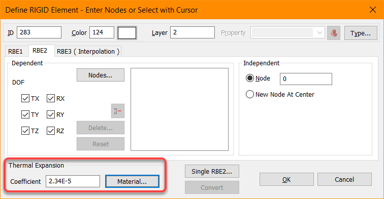

In FEMAP, the Rigid element CTE is defined by using the “Coefficient” field in the Thermal Expansion portion of the Define RIGID Element dialog box.
A coefficient of thermal expansion for any Rigid element can either be entered directly into the “Coefficient” field or copied from a defined material using the Material... button in this dialog box.
When using RIGID = LAGRAN in the NASTRAN CASE CONTROL, K6ROT must be defined as non-zero.
The LAGRAN method allows for the thermal expansion of the rigid elements.
